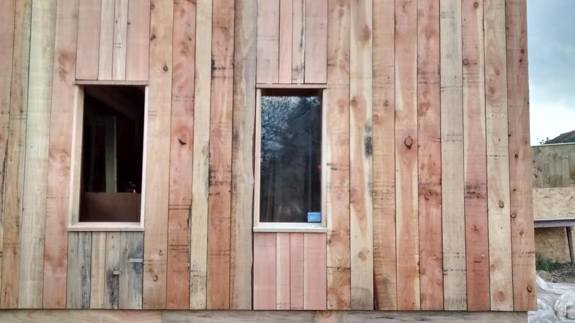

If you want to do it quick do a cladded timber frame, you need 2m from your boundary for timber cladding.
No problem in doing a timber frame with a brick/block outerskin.
25m is a long wall so if you are doing it in block/brick remember expansion etc
Me likes timber cladding though
