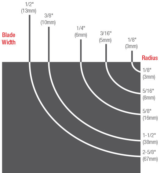

I finally committed to buying a bandsaw for splicing in timber when working on exterior windows. I am aware that I should have done so years ago.

I am working on the assumption that the blade supplied (6mm) will be "budget" quality. The specs say that it will accept (1712mm) blades from 3.5-12mm.
I have never previously owned a band saw. Which blade depths and tooth pitches/offsets should I be looking at? I very much doubt that it will (initially) be used it for anything other than ripping timber along the length.
I would like to buy a better quality blade for ripping, should I go for the max 12m blade for straight rips (and which tooth pitch (mainly soft woods)? And if I do, can I still do slight curves in 50mm tall timber?

A great choice...I was responsible for the purchase of a good few of these machines - albeit an earlier model - for school classroom use and they were excellent.
Our preference were to use 3/8” blades for general use, 6 or 10 tpi if I recall as these would do moderate curves, whereas trying to curve with a 1/2” blade caused the blades to squeal through the guides - but was great for ripping with a fence.

For straight ripping, if you aren’t too bothered about finish, get the coarsest blade you can.
I’d be surprised if the machine could tension a 1/2” blade, so go for a 3/8”
by the way, if you use a blade for cutting curves, you will struggle to get it to cut straight after, curves seem to blunten the blade one side making it not cut straight.

There are three main tooth forms: regular, skip tooth and hook tooth. Skip and hook are both used for ripping - hook tooth are a lot more aggressive, but not available in all blade sizes. Regular tooth give a smoother cut, can wander more on rip cuts and the gullets can load up quickly if you cut timber which is too thick (see below). Metal blades are different so I'm not including those
The tooth count is dictated by the thickness of material you are cutting, but you aim to get 3 to 6 teeth in the cut on wood and softer plastics, rubber, etc (in metals it is 6 to 18 teeth). This means that a 4in thick piece of timber could be ripped with a 1 to 1.5 tpi blade, whilst a 12mm (1/2in) piece should have a 6 to 12tpi blade

The radius of curves you cut is dictated by the width of the blade - the narrower the blade the tighter the curve, but the wider the blade the straighter the cut (important for ripping). This diagram shows what you need to know - print it out and stick a copy on the cover of the bandsaw:
You can ease the cutting action on tight curves by running the saw and radiusing the back edge of the saw blade with a small oilstone glued to a wooden stick - be careful NOT to get your fingers near the front on the blade! Knocking the square corners off the back of the blade makes tight curve cutting a lot smoother

If your widest blades are 12mm (1/2in) I'd suggest not exceeding about 3/8in (10mm) wide blades. This is maybe an old bias, but I have always been of the opining that fabricated sheet metal band saws just can't tension the maximum width of blade that the makers say they can accommodate
And on the question of tension if you do a rip cut and the cut isn't straight then you aren't running enough tension on the blade. With saws that have rubber tyres (i.e. most modern saws) I was taught that at the end of a session the blade tension should always be slackened off a bit to prevent the blade permanently marring the surfaces of the tyres and causing rough running and/or tracking problems
