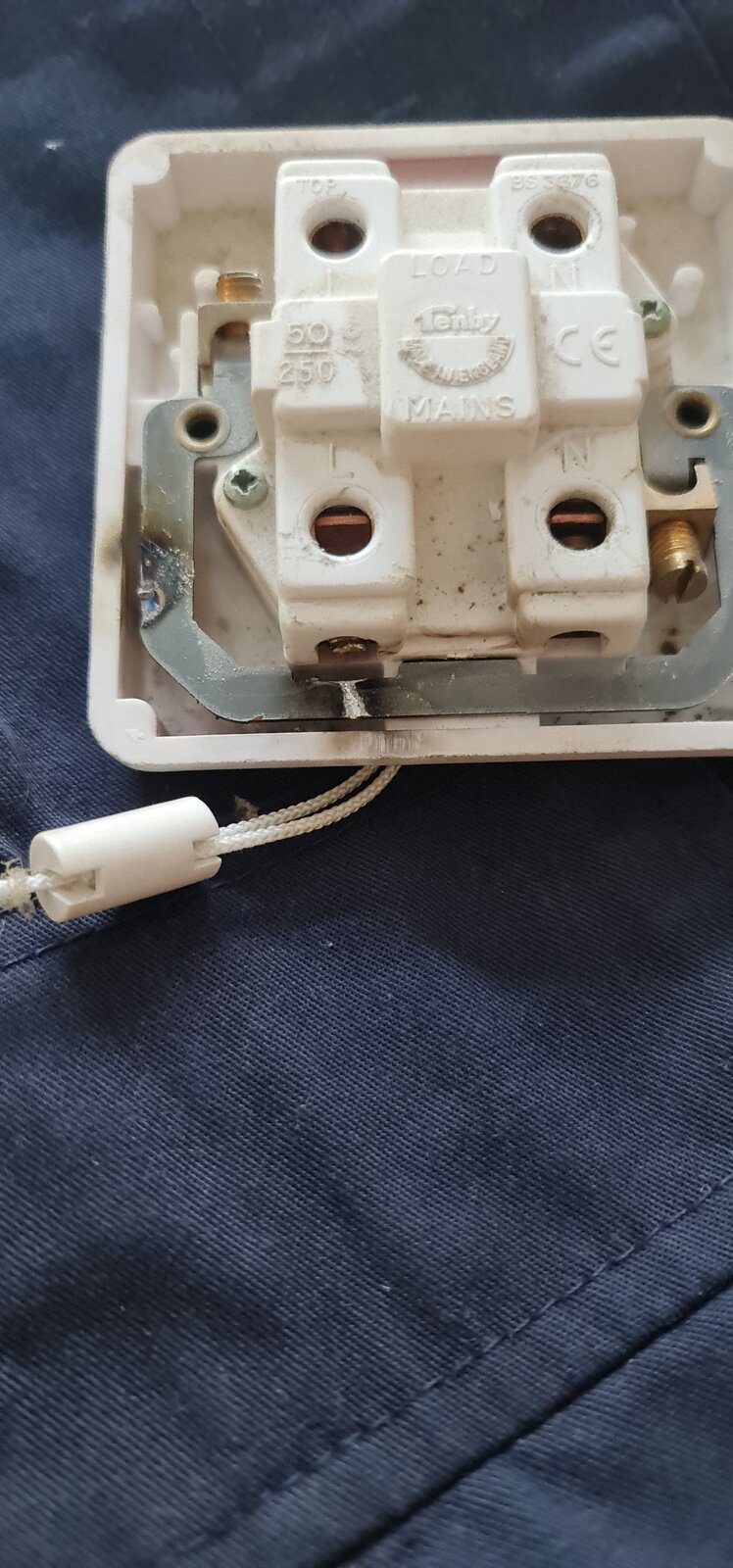

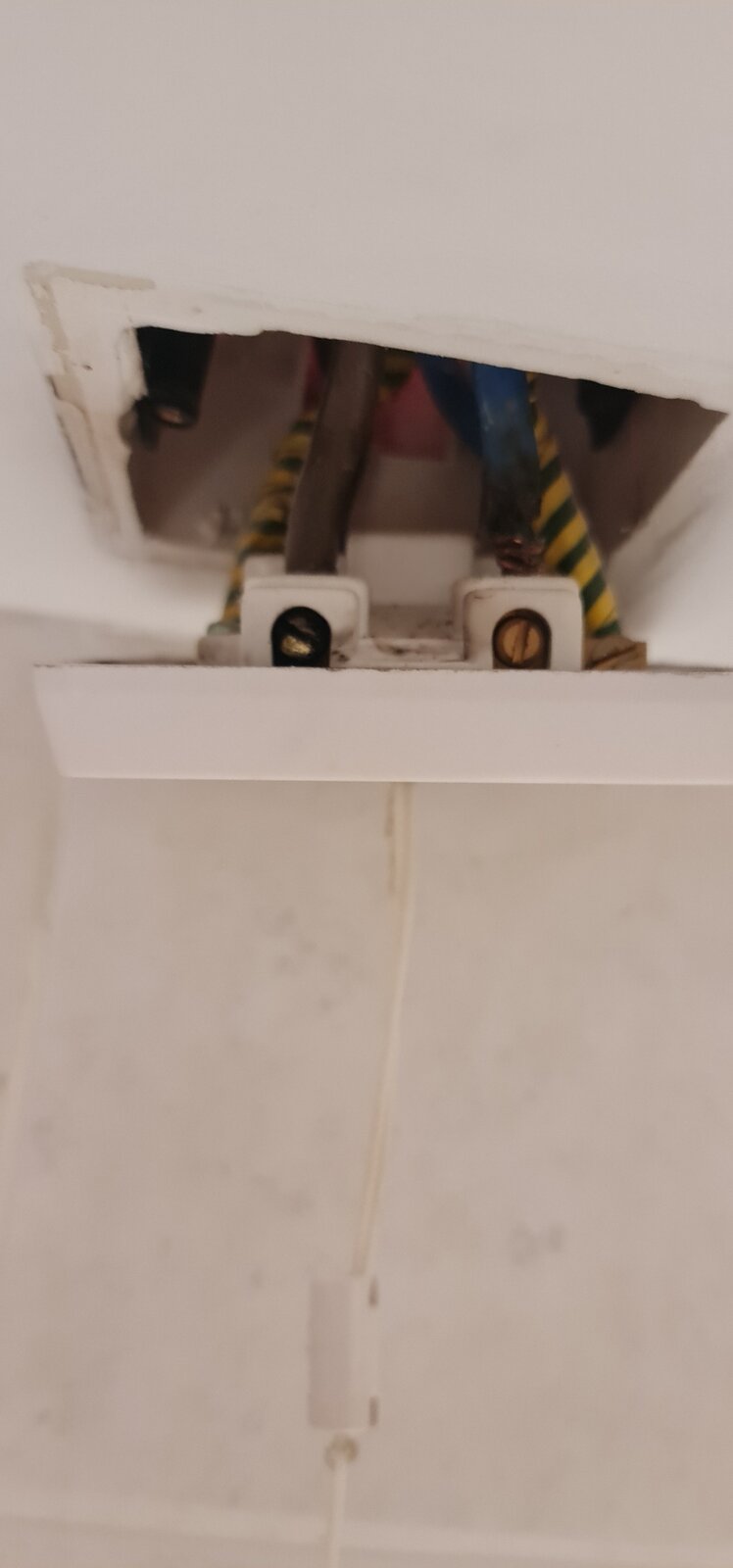

Swung by my mum's yesterday. My stepfather mentioned that the pull cord isolator for the shower had stopped working. He had loosened the screws for the fitting. I had my screwdriver in my pocket- the type that has a green and red LED and can show current via induction. I pushed the slotted head into the live on the left... and BANG.
You can see the arching on the screwhead (not there previously).
I am at a loss as to why it happened. The fitting is plastic. I cannot see how I bridged anything. It tripped both the RCD and the MCB. I didn't notice any water in the ceiling fitting.
Very odd.
Yup you were both correct.
Turns out that the earth plate is pretty much flush with the edge of the plastic body.
No idea why there is evidence of a second arc on the left hand side.
Thanks for your sage diagnosis gents.

Judging by the charring on the blue cable the Neutral on that circuit looks like it was loose too. I always prefer Crabtree isolators, they look a bit big though.
Just wondering why you stuck the screwdriver in the live :giggle:
Does that screwdriver not, as you mentioned show its live via inductance
Yeah, the neutral was loose. I cut it back before fitting it.

Good question. I just wanted to see if the screws were tight. Additionally, the inductance part of the screwdriver does give false positives. The inductance makes the green LED glow. Direct contact makes the red LED glow.
