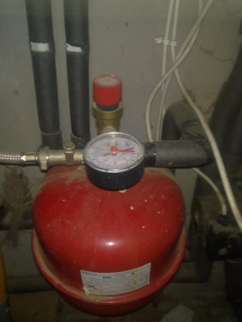

The heating system is an oil based sealed System with a conventional boiler. The pressue is set to 1 bar, 0.5 bar at rest. The pressure pump is set to 2.

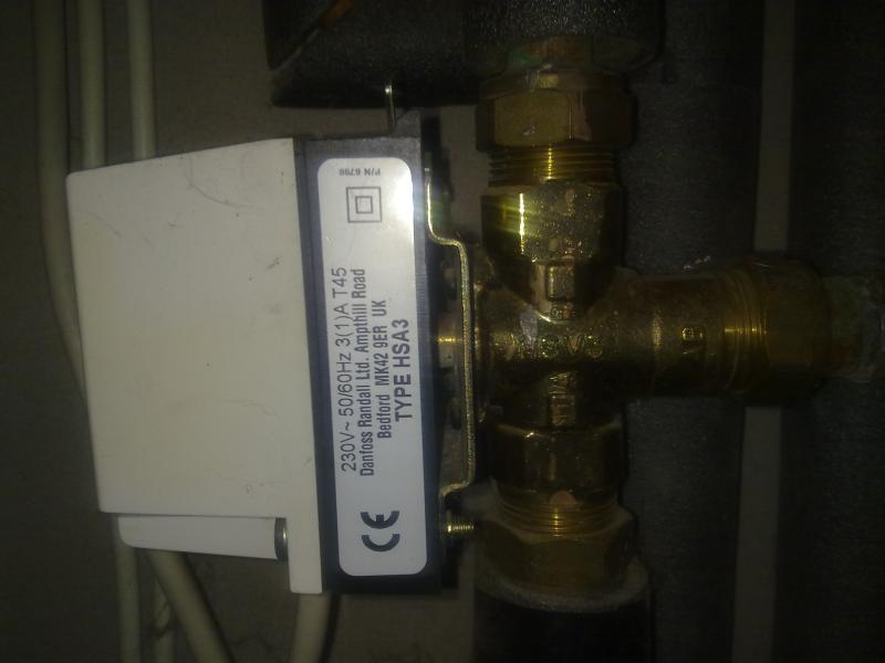

I cant spot a make on the valve but its model number is HSV3, see photo below:
Any further advice very much appreciated.
Andy
Valve is connected correct way round.

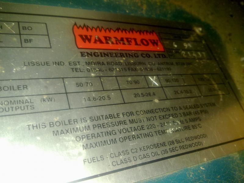

Which make & model boiler do you have?

Heres an image showing the plate on the boiler and its make and model info

The fact that the banging stops when the HW is switched on and after the motorised valve moves position surely indicates that something is faulty either with the motorised valve head (part HSA3) or the valve (plumbing part "HSV3" ) itself ?
In my first post i mentioned that we have had the motorised valve replaced twice already, i want to clarrify that by saying that we had the motorised head part replaced but never the "plumbing part"...

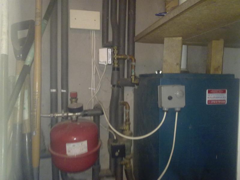

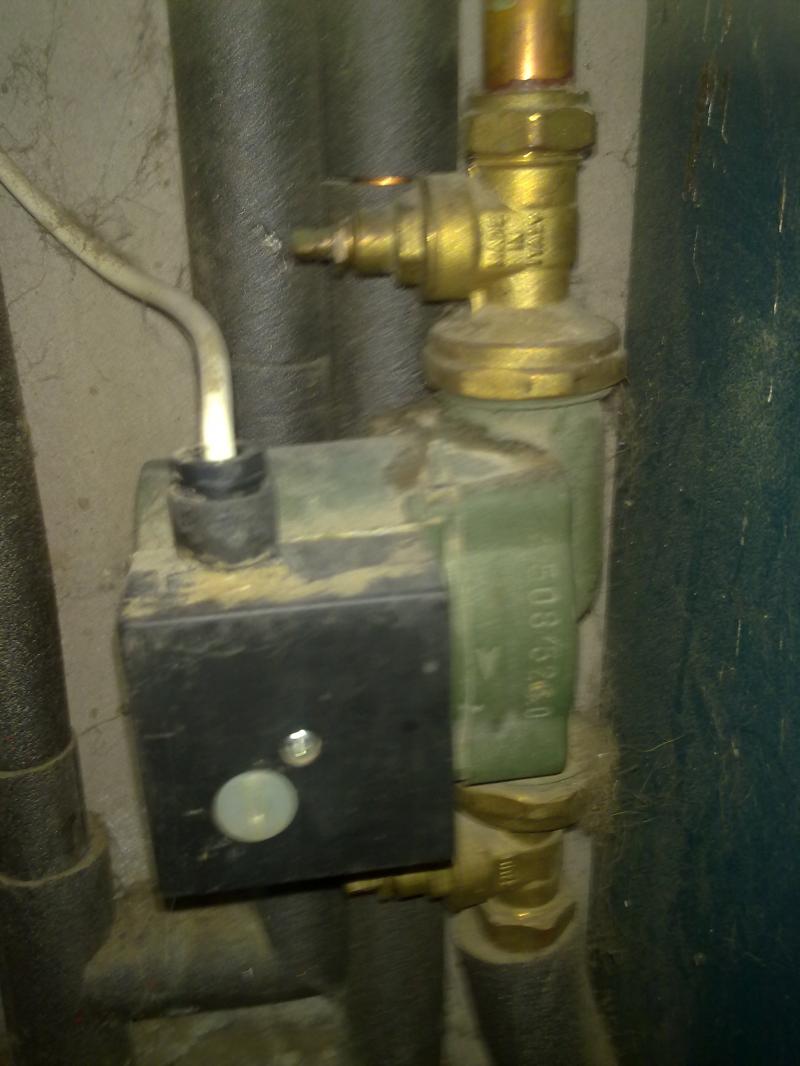

can you post pictures of the valve, pump and any thing else connected so we can see how the system is plumbed in.

How old is the valve body, i.e. the "plumbing part"? Is it as old as the rest of the system appears to be? If so, the noise may be due to the innards rattling around because it is worn out.
Its about 10 years old now i guess.
If it is the innards being worn out, why does it stop banging when i click on the HW? Should i not notice some issues if the innards were dodgy, i.e. the HW not going to the tank or the radiators?
Andy
It's the way the valve works. When CH has finished, e.g turned off by the room thermostat, the motor continues to hold Port A open. So if anything is loose inside this might rattle. When you turn HW on, the motor is disconnected and the internal spring takes the valve back to its "rest" position - Port B open. The spring is strong enough to hold the valve closed without ratting.
If you decide to change the valve, get a Honeywell V4073.
