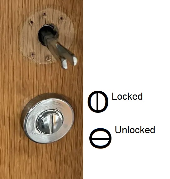

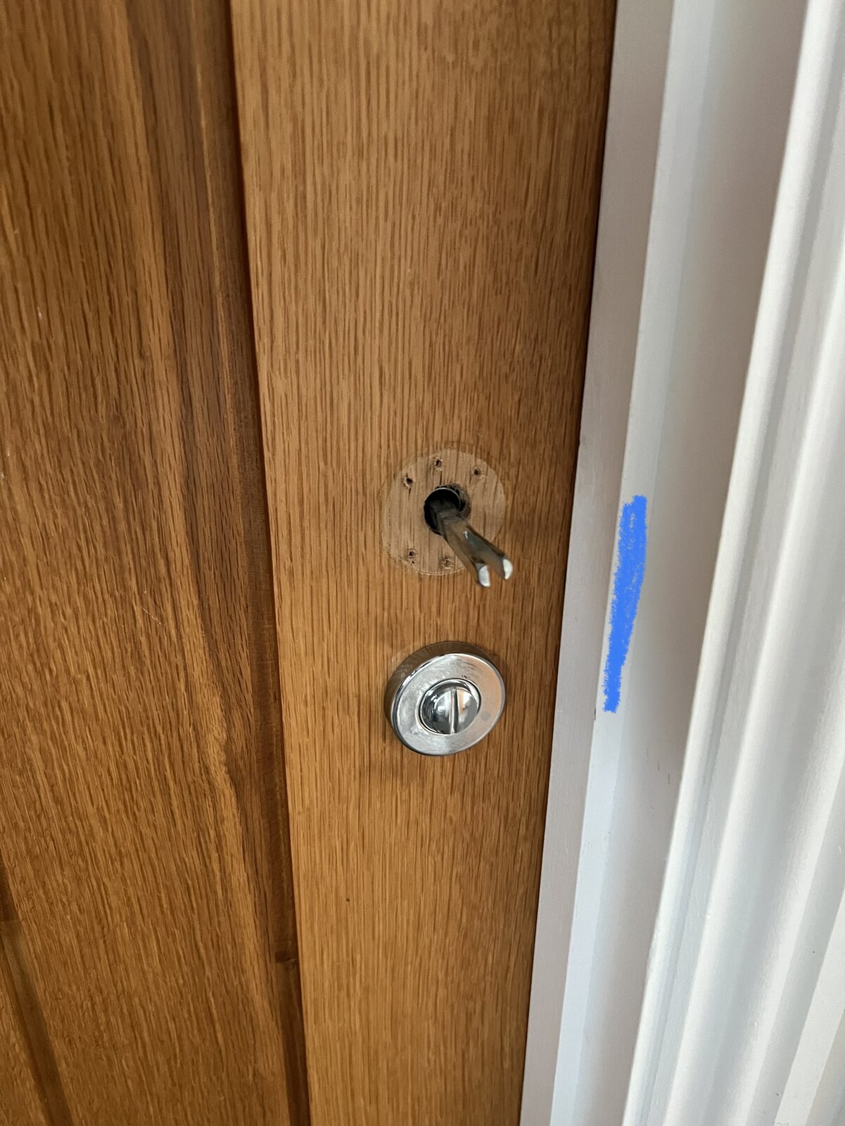

bath door not opening
Have you tried turning the lock release to be horizontal
Thought you might be on to something here but I have the same lock on my other bath and it works in the same way. Upright is unlocked. However, I did move this around and I can feel the lock engaging when this is horizontal. This is not the issue here. It's the broken mechanism for the latch.

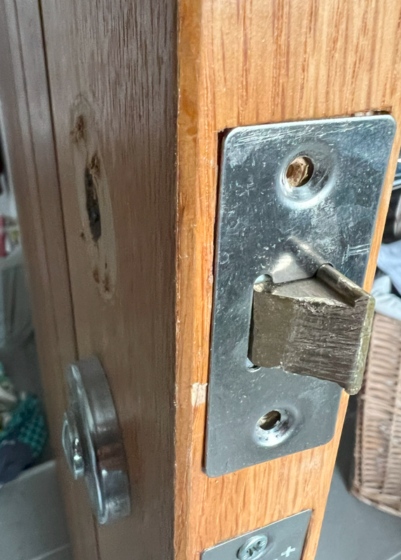

A thought, can I drill some holes or may be use my multi cutter to create a gap at the base of the door jamb? Around here perhaps
This will expose the latch and I can then slide a flat screwdriver to squeeze it back.

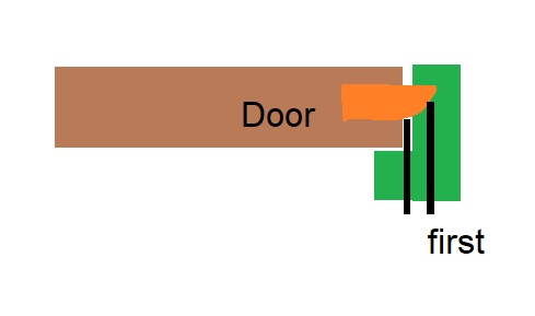

Creating series of holes might enable the bolt to be pushed back step by step
Drill first hole as far as the bolt, then push a rod ( nail ) into the hole to push the bolt partly into the door. Leave the nail in place.
Then repeat until the bolt is clear of the door frame.
Use the other bathroom door lock to get the measurements of where the first hole should be drilled

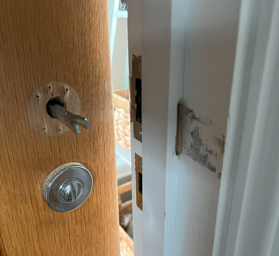

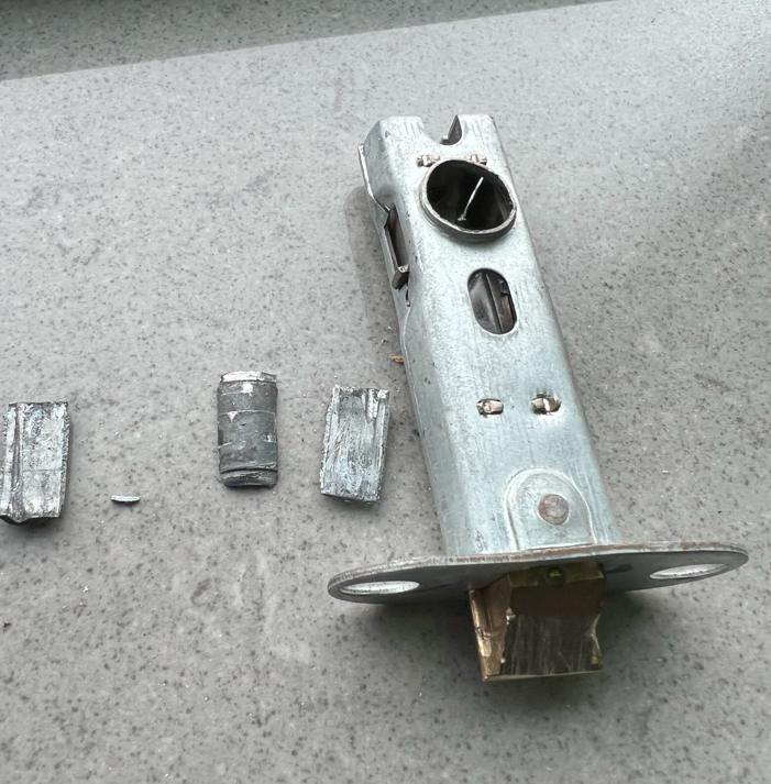

UPDATE: We have an open door!
I went with the approach I proposed above - informed by the suggestions I received.
Bit of filler and paint and you'll never know that it was ever there. The door is unscathed.

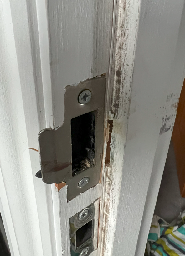

Now, can I please get some advice on what I need to replace and where I should get this from. Here are the bits I pulled out:
I look forward to your suggestions. Thanks again.
You'll have to pop to screwfix or B&Q or wherever and find one that fits ie same hole centres, catch size/distance from door edge to spindle etc, unless it has a manufacturers name or model or if you have an ironmongery place nearby that might be easier. I lucked out when mine went, turns out they were all bog standard screwfix ones, crap quality mind.
For next time, you may be able to make a card shim from a thin tupperware/polypropylene container and jig it around the stop to push the latch lever.
There is the lug i mentioned which if you had got just above the barrel with a thin flat driver you could have released it without the damage to the frame but you got there in the end.
