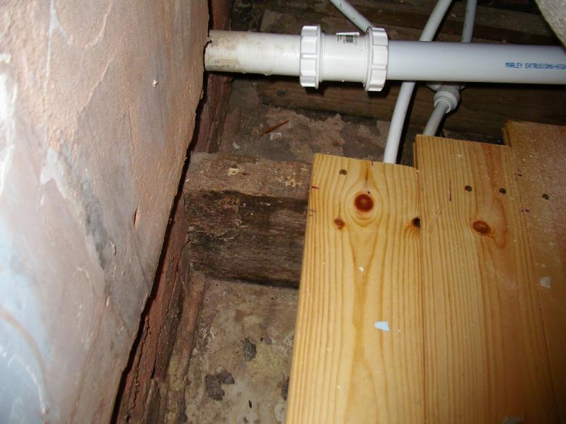

I've uploaded a couple of pics.
//www.diynot.com/network/weird_dave/albums/3187
The first is just the bath to get an idea of how it is in relation to everything.
Next is one of the skis
Then we have the joist nearest the wall (no laughing at the pipework!)
4th is the same joist. as you can see, it's been braced once already. I then took up the floorboard you see on the left.
5th is the 2nd joist, runs about midway down the bath.
6th is the end of that joist.
Not too sure how much help these pics will be, but I appreciate all the support (no pun intended!)
In this picture
it looks like the joist at the very back, beyond the waste pipe, doesn't actually go into the wall! If this is the case it will need repairing.
Is there any way of monitoring whether this joist moves as you fill the bath?
What about the ceiling in the room below?
The joist is braced with another piece of wood, which is mostly what you can see and doesn't go into the wall. If you look to the right, you should see the joist behind it.
