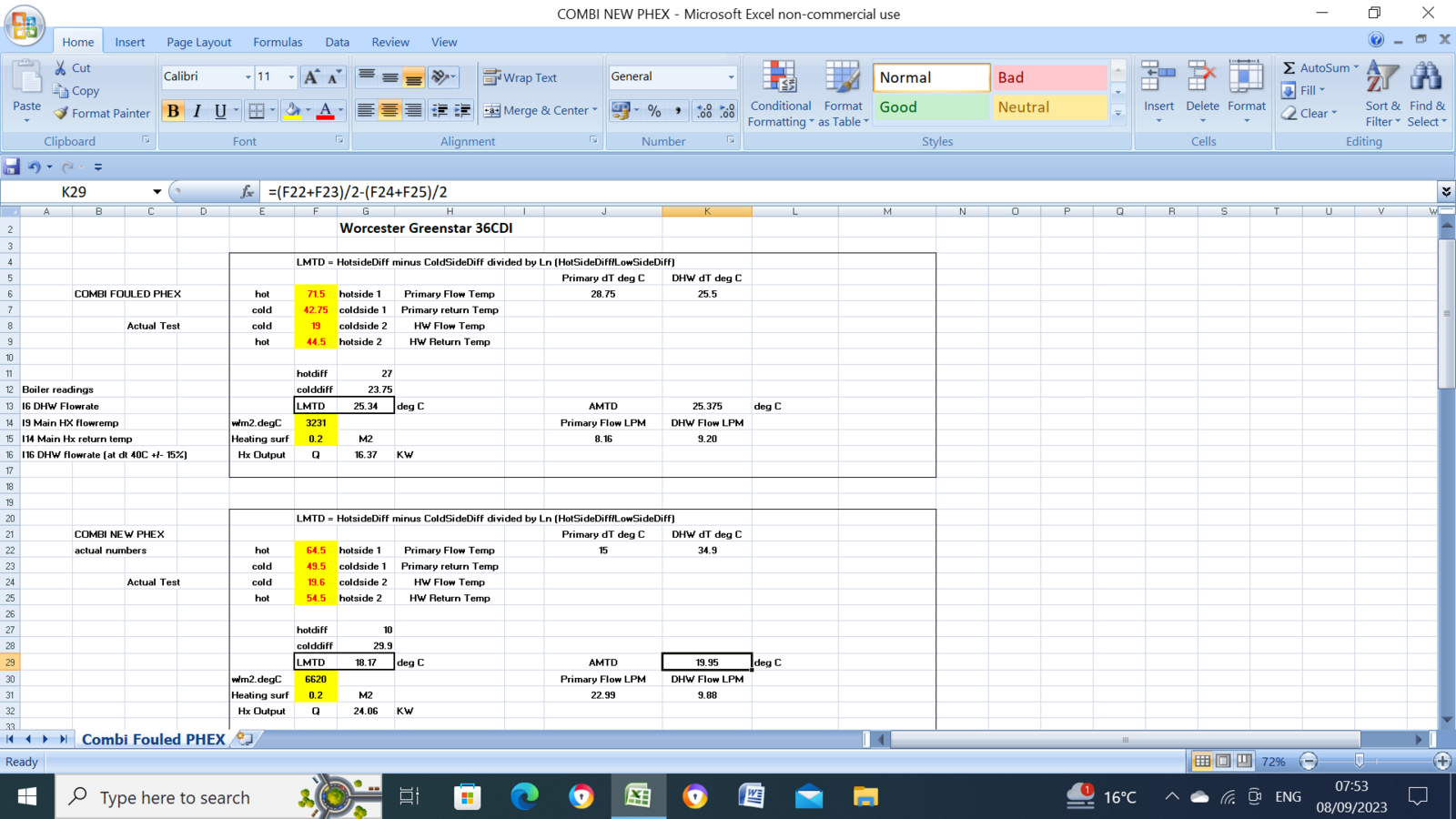

Reporting back as we have now had the plate heat exchanger replaced and boiler is working great and bath hot water stays consistently hot now! Hurray!
With the DHW setpoint at 55C I am getting the following readings:
i6 9.6LPM-10.2LPM
i9 64C-65C
i11 54C-55CC
i14 49C-50C
Previously i9 which is the temp from main heat exchanger was getting up to 88C so now much more sensible temps.

The boiler output is 23.83kw, by calculation.
The increase in primary flow is amazing with the new PHEX, the previous flowrates were ~ 8.5LPM but with the new one because the primary dT is now only 64.5-49.5, 15C and the DHW dT is 54.5-20, 34.5C then the primary flowrate is now 9.9*34.5/15, 22.77LPM, the primary side must have been severely restricted?

These might be of interest as it shows the huge difference in flowrates and heat transfer between fouled and cleaned PHEXs. I have assumed a PHEX heating surface of 0.2M2.
