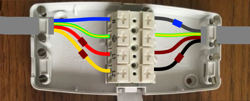

Too much condensation in a small windowless bathroom to a point it drips from walls and everything in bathroom. Manrose m100ft inline fan is 3 times more powerful and will likely to help with this.
Presumably it doesn't matter whether we use the 1st or 2nd port in each of the 4 terminal blocks so long as the wires opposite is the correct one and aligned?
Doesn't matter. All four in each block are connected together.
It wouldn't be a lot of use as a junction box if all the ports were separate.
Just to update I managed to do this over the weekend and everything working fine, thanks. I saved £150 which is what one electrican quoted me to do this job. It took me the whole day to do this but this is because I like to make sure everything is ok, seals ok and drill holes all aligned correctly for the manrose incline fan, and other bits. The electrican may have done it faster but quite often I find builders don't do this properly and most of the time they don't have the right screws especially for hollow plasterboards.
