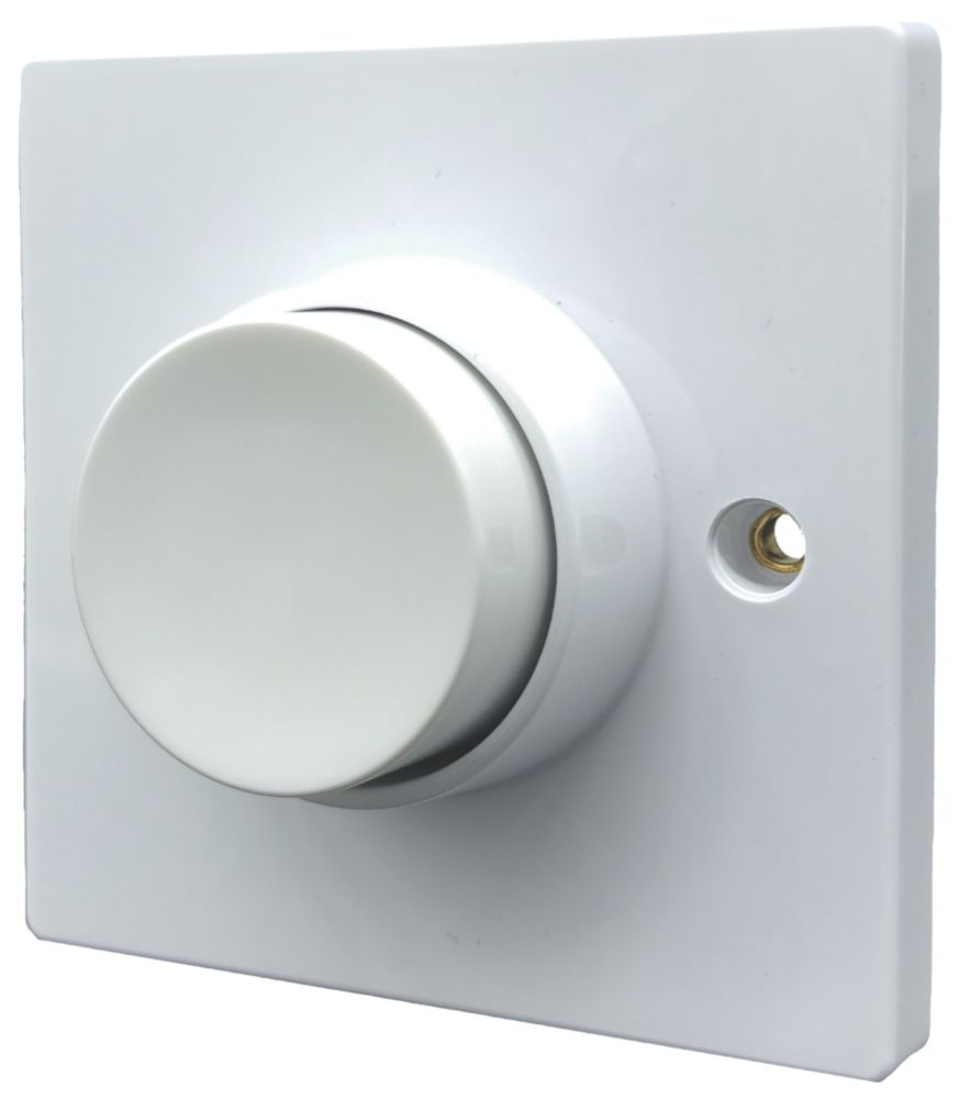

The triple pole fan isolator is for maintenance purposes, so fan can be worked on whilst leaving power onto lights in the same room.
The standard fan isolator allows you to lock off the supply
with the attachment seen in red and the three connections are for permanent line, switched line and neutral switching neutral so with a fault you can work on it with light with out tripping RCD.
