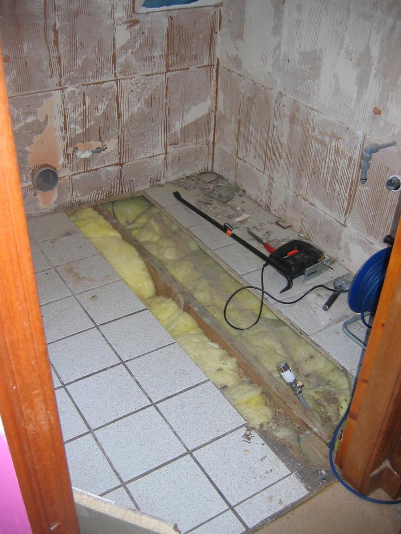

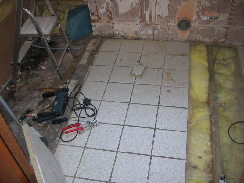

First off in reply to gaz, So because I am putting a 25mm WBP ply board straight onto the floor joists, I need to use a special type of adhesive? Im guessing that type of adhesive will be a tad more expensive which leads me to think on my next question.....
Do you think Id be better off putting a 9mm ply floor down first and then putting down 15mm so as to avoid this problem or is this not worth offsetting the cost of the C1S2 adhesive.

Using 2 layers of ply to achieve the same overall thickness is not what Gaz means; he’s referring to overboading standard floorboards (18mm) with 15mm ply which is not your situation. BAL don’t recommend using C1/C2 adhesive unless the floor is over boarded & they (along with most other adhesive manufacturers) also recommend 15mm as the minimum overboard which is also the BS recommendation; for sure it will probably never fail but in most cases is way OTT. It gives a ridiculously high threshold & 12mm overboard is generally recognised as sufficient in most cases but each floor must be individually assessed. Using 2 layers (9mm + 15mm) of ply will never be as rigid as a single 25mm ply base; my advice is to stick with the 25mm & tile onto that. Single Part Fastflex (C1S2) is relatively new & does provide more flexibility than Rapidset Flexible (C2F2) but I’ve used Rapidset for several years over rigid suspended floors (reinforced in some cases) without any failures or comebacks. Fastflex is, however, cheaper than Rapidset Flexible, so am not sure what you’re comparing it with or where you’re getting your prices from?
By the way, what size pitch & span are your floor joists?
With a tape measure, measure the depth & width of the timber joist, then measure how far apart they are (pitch). The joist span is the distance between the walls/beams underneath which are supporting the joists; you should be able to ascertain this from below or you might have to wait until you have got the floor up before you can tell.

floor remove,check spans/dwangs ect.. and if needed sister up joist and add extra dwangs if needed..
then over lay with 22mm or 25mm wbp ply and use a adhesive speced for the job,there are many mfr off adhesive out there..mapei/bal/weber/ardex..etc..
