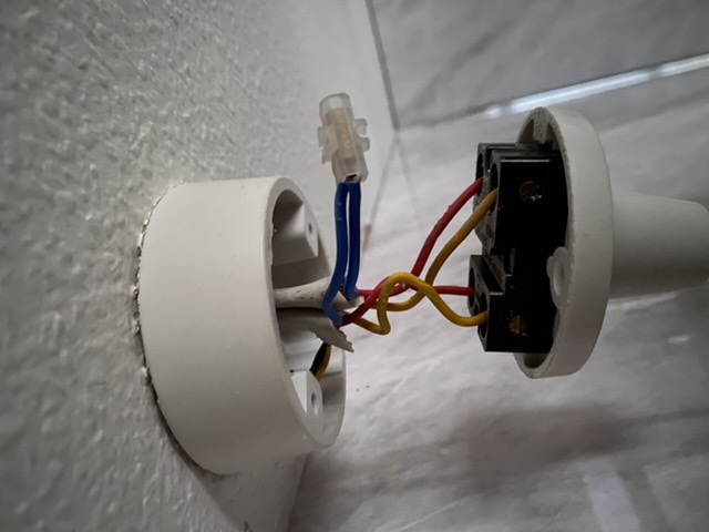

I can’t find a isolation switch anywhere. The fan has been disconnected Due to tiles. Those three wires are now in a block. The light worked fine before I took the Rose off and tried to wire this new led one!. If I wire in just the yellow and blue from one cable into the new light it doesn’t trip. But as soon as I add any of the yellow or blue from the extractor cable it trips?

Show pics of the terminated cables conductors at fan position.
Was that terminated as you described whilst old light fitting was on and working ? Or have you terminated it as a part of fitting new light today ?
It’s been terminated for a while now into a block of three with a cable in each hole the same way as the extractor fan. The light was working fine. Then I decided to change to this large led one. Why oh why didn’t I take a pic of the ceiling Rose before taking all the cables out

When the device tripped FIRST time ,what was the wiring configuration at the new light fitting ( what coloured conductors connected to what) ?

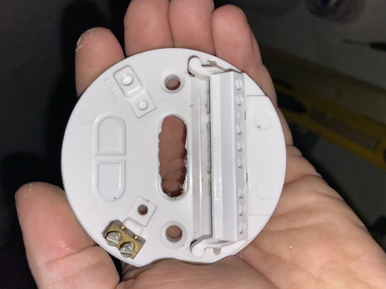

Yes two pull cords in bathroom, one for each. I turned the black lever off on lights on the fuse box. Wired in (which I thought was same way) new light went into garage to flip black lever back to on and it wouldn’t stay on
That’s the old ceiling Rose. I’m sure it was two blue on left with a blue jointing to light. Two red in the centre. Then two yellow on the right with a brown joining to light. I have wired this new light in the same way. And have tried putting the old ceiling Rose back but it just won’t work. All I can think is I have not remembered correctly which cable was where

Yes pretty sure the fan used to turn on when Turing light on, but could turn the fan off with its own separate pull cord. What am I checking with a multi metre? I will go buy one now from screwfix if I know how to use it?
