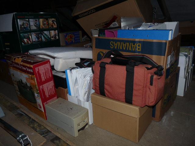

Hi securespark, so you mean the two red and brown should all go into common on the switch? I've been up in the loft and the situation is not great. One of the reds leading to the light is loose, but fortunately it's not live. But the loft floor is boarded up, so to get to the other wires, I'd need to shift loads of boxes and get the boards up - a job for the weekend perhaps.

You can't see where it goes 'cos the loft is boarded....... :cry:
