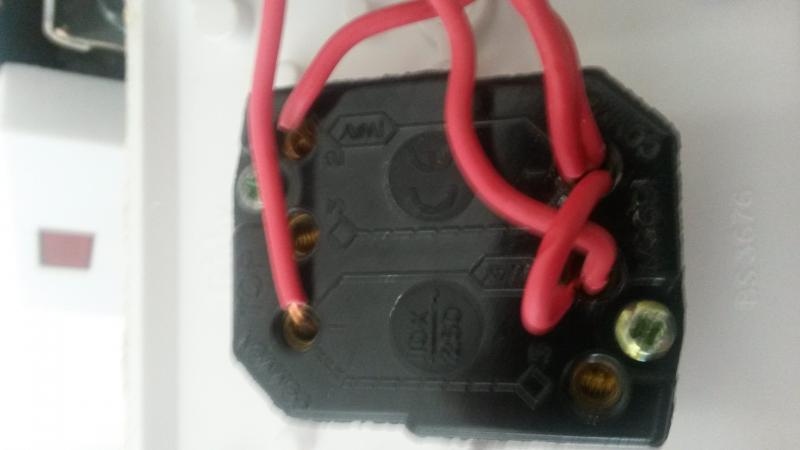

Hi,
I'm a newbie to electrics. I'm trying to replace an old light and fan switch in the bathroom. I'm having trouble finding a replacement, probably because the old switch is 15 years old.
I can't find anything remotely like it at B&Q. It's a 250v 10a plate. Think it's a 2-way plate but all similar 2 way plates I've seen don't look anything like this one. Plus there's a small wire on the picture which is 'looping' between two sockets which I don't understand.
Any help appreciated!
Steve

To be clearer, can we have a picture from farther away so we can see where the wires go?
Also, how do the light and fan work?
Light and fan totally independent?
Fan only on with light but able to switch off fan?
That sort of thing.
Is it a pull string switch or wall switch?
Looks like a 2 gang 2 way which I didn't know they Made in pull switches
Is it a pull string switch or wall switch? Looks like a 2 gang 2 way which I didn't know they Made in pull switches
Yes, it's clearly a 2-gang 2-way switch, but I can't say that I've personally ever seen a 2-gang pull switch of any description, so I rather doubt that it is a pull switch!
Kind Regards, John

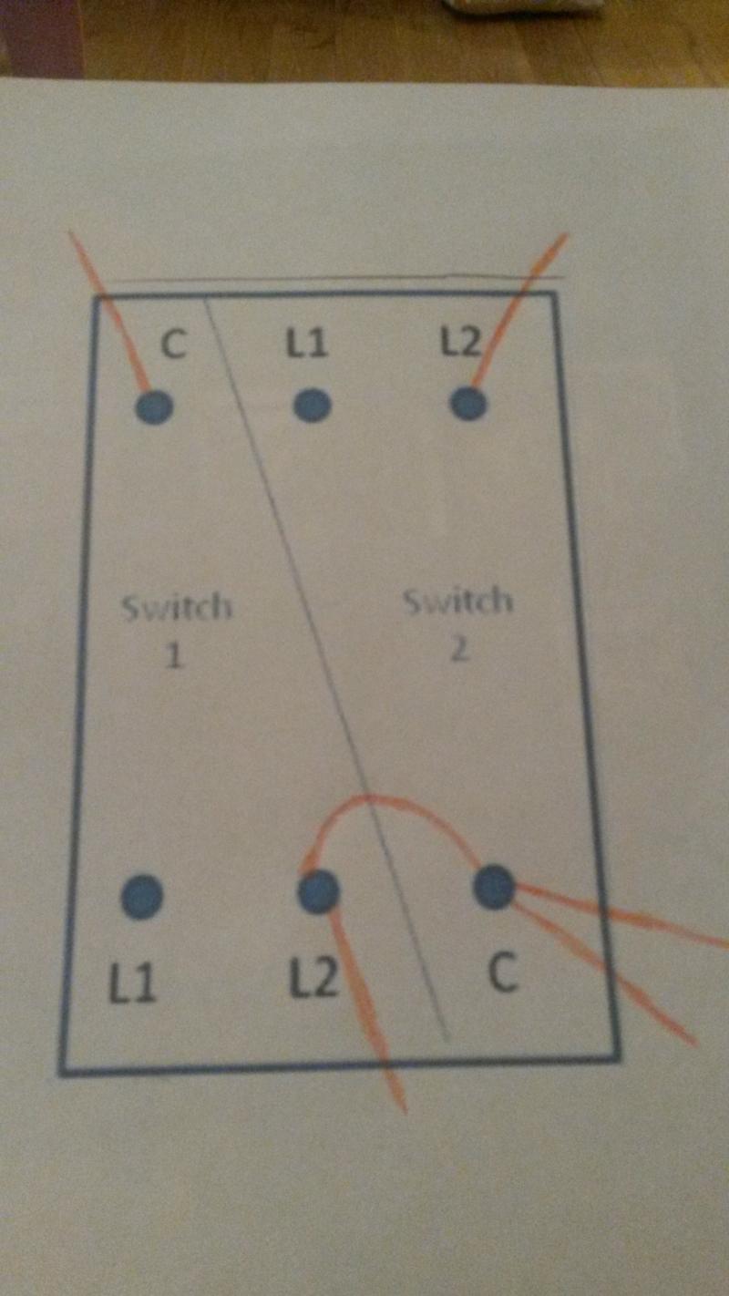

Your existing switch is in two halves. Look at it liketwo triangles with one upside down. A bit like this
Now, each of your switches are labelled 1, 2 and 3. You will need to buy a 2 gang, 2 way switch (any type) and tell us how your new switch is marked up.
Sometimes the terminals are C, L1 and L2, Sometimes L1, L2 and L3. and there are several other variations.
Also, all of your wires are the same colour, so there are lots of ways to trip up the unwary!
Suggest you get a permanent marker and mark each of the wires on that switch (i.e. | || ||| etc and take another photo.)
Go buy yourf switch and report back, and we can tell you how to transpose from the old to the new, that is unless you have worked it out for yourself!

Thanks for all your comments. The switch is not a pull switch its just a normal switch. The fan and light are completely independent.
Taylortwocities - cheers for the diagram. Based on that I think the socket is wired up as follows :-
1)
Ive now bought a 2 way 2 gang switch :-
2)
The challenge now is getting the wires in socket 1)
linked up to socket 2) :rolleyes:
Thanks again for all your help.
Cheers
Steve
To make it easier for you (maybe ) put the 4 bottom wires inc link between the common terminals
The top wires on your diagram goto the 1 waY terminals
