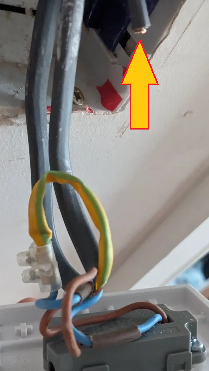

Good shout Sunray . Further clarification required ,and if indeed there is a blue wire in that connector block with the earth conductors thats a problem.
This needs to be investigated before making any changes.
Do to have any test kit?
Are 2 earth wires in the sleeve or one?
Does the fan run on (continue running for a while after the light is switched off?
What is the other wire in the pic?View attachment 310792
Can you see the wiring in the fan?
Can you see the wiring at the light?
Unfortunately not!
I think just one?
Yeah it's on a timer. Runs for about 15 mins after it's off.
That's just a loose cable that's not connected to anything. It was originally for a wall light that doesn't exist any more I believe.
If I take off the fan cover I probably could
Again, I'd have to take it off the ceiling to check.
(This is why I am against the advice that is sometimes given here about tying unused cores to earth terminals - it causing confusion and sometimes a potentially dangerous situation.)
That blue wire needs urgent investigation before anything else is done.
So I think it might be connected to the fan isolator switch? I honestly don't know exactly.
I won't do anything until it's all investigated
