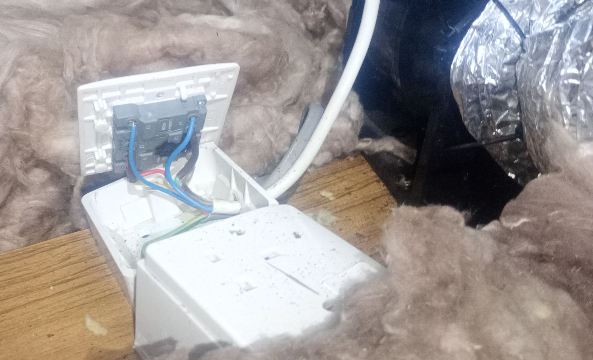

The one time I saw this it was a twin to the bathroom light switch which had no CPC and a screw had been put right through the middle, shorting out the live and switched live when putting down loft boards.

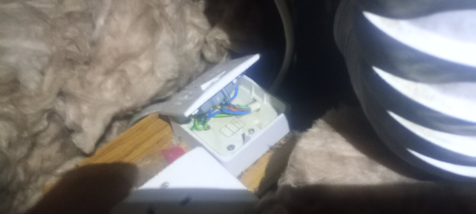

I think I may have tracked it down with your help. The switch next to the fan in the attic opened it up, and its wet inside.
I am assuming there is a slight leak (although none I could detect) from the roof tile vent used to extract as the switch is situated nearly directly underneath (this was installed by an electrician).
I have put it all back together and switched the switch off.
Is it also advisable to switch off the upstairs lights on the main junction box permanently and make do with temporary lighting until fixed?
Should I re-site the fan in the attic?
Or is the fan housing OK, and could I change the switch to be a waterproof outside version? If so, what do I need to look at?

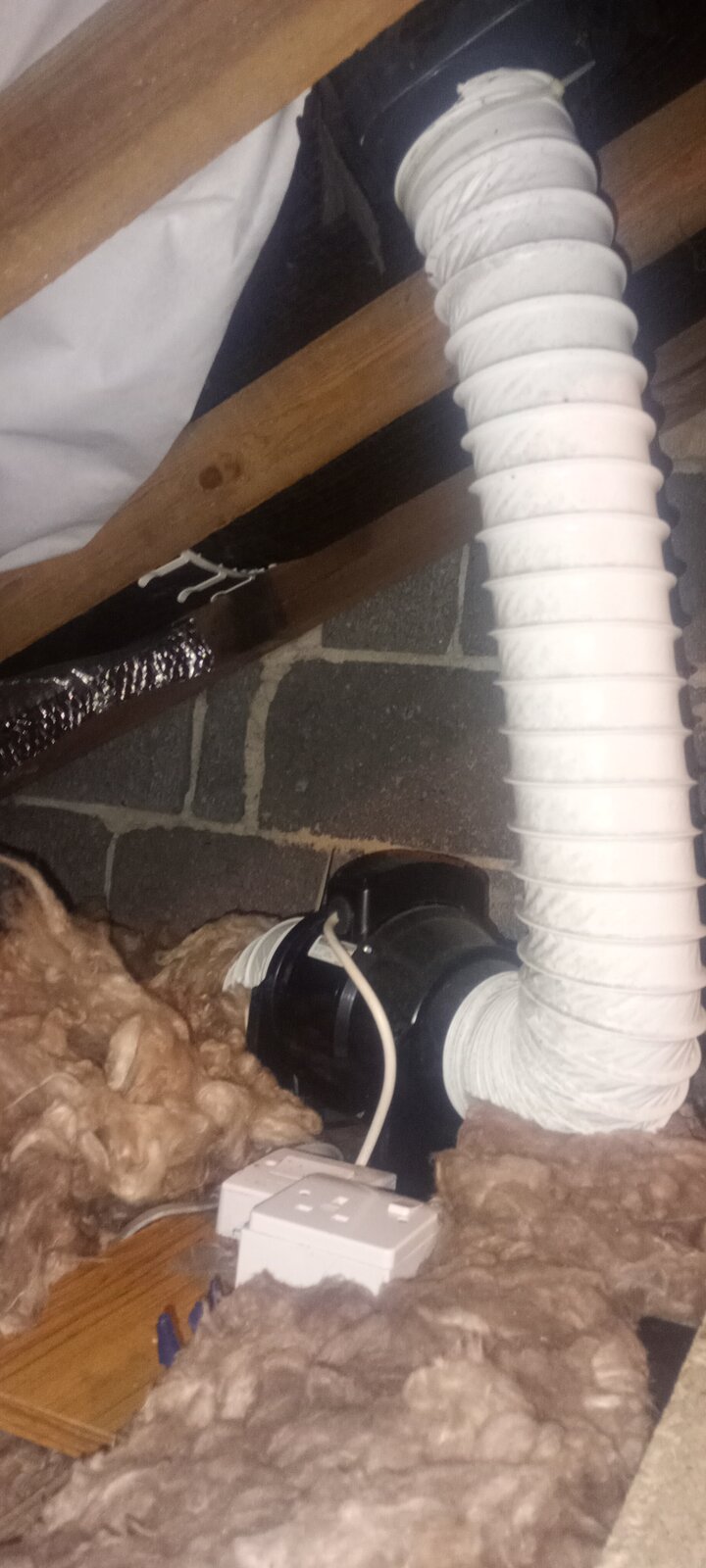

I could be wrong, but.... moisture that condenses on the inside of that hose is going to run back down in to the fan. Maybe the fan is designed with that in mind so it doesn't matter.
I was thinking the same.
Have noticed when fan ducting goes straight up vertically, with no horizontal section of ducting, the fans tend to fill up with water.
When I had this issue I also made the whole length of pipe and the fan as straight as possible between the ceiling hole and the roof hole.
Looking at you photo I would sugegst you consider mounting the fan on the wall and putting the Duct pipe as straight as possible.
