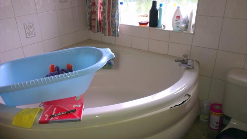

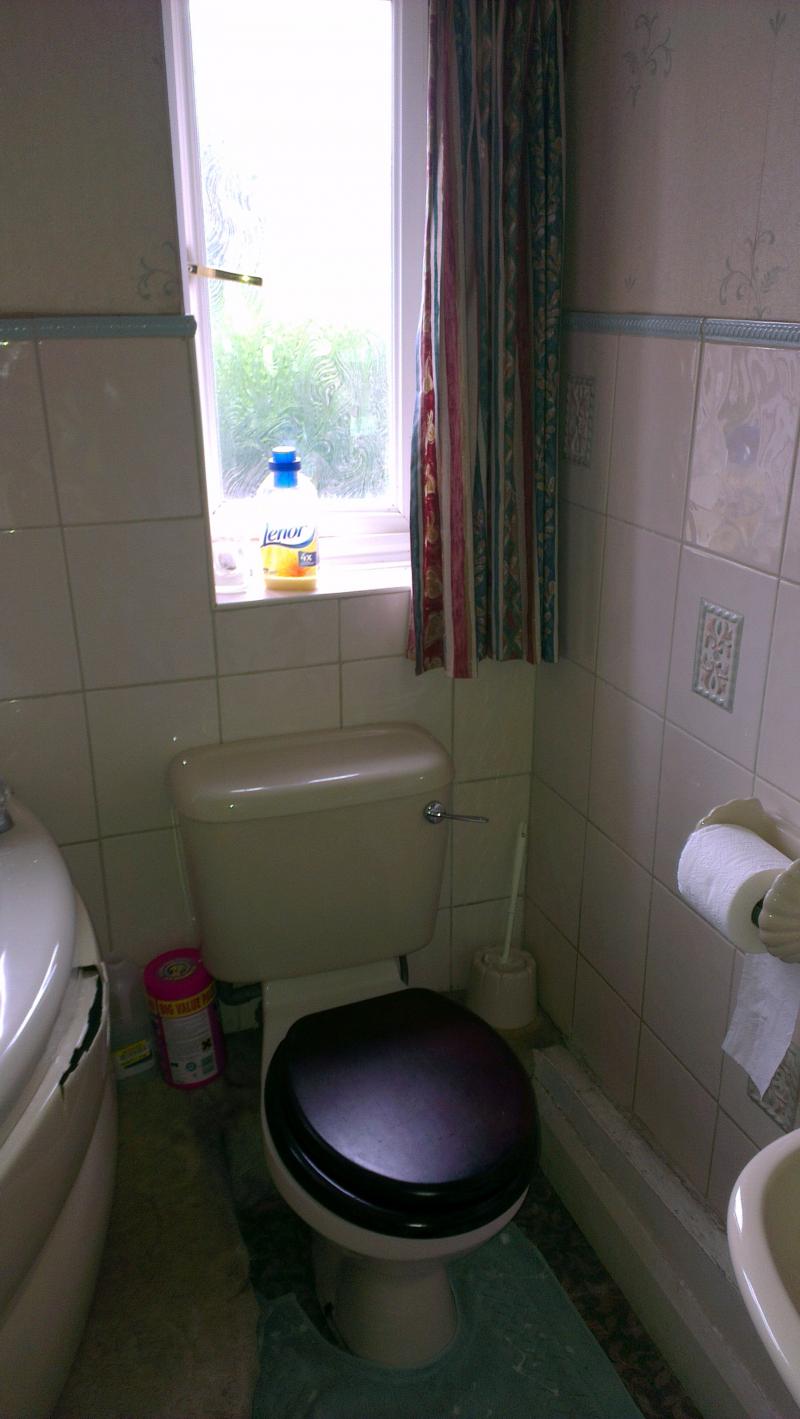

I've been asked to redo a bathroom, its not a friend so not after mates rates, but as its the first full bathroom i'm taking on, I was hoping some of you guys who have experience in this area could give me an idea of what to charge.
The bathroom is not square as it has one wall slightly angled. They want the walls tiled halfway up, so roughtly 12sq meters.
The floor where the corner bath and shower cubicle are has been raised, they want this raised box removed and floor all the same level, and want floor tiled. Area is roughly 7 sq meteres.
The want all old suit removed, bath, toilet, basin, shower cubicle and want it replaced with like for like new suit. They also want to change the thermostatic shower.
Below are pictures of what it looks like now.
I'm in Birmingham so would have to be rough birmigham type rates.

I had a look under bath and the water pipework will tuck in nicely behind the bath, even if the raised floor is lowered. However the waste from the bath is level with where the lowered floor will be, so the waste water should still drain away. The shower waste was not visible so assuming its under the raised floor.
I was guessing at about £1000 labour, but i now get the feeling this might be too low.
I've fit a couple of bathrom suits only previously, and I would say it takes me two days to remove bath, toilet and basin, and fit the new ones. So kindof slow i guess! All this work i reckon it would take about 7 days, possibly more.
