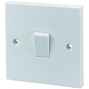

Thanks flameport, I would have gone with the inline fan option, but there is an existing 240V fan in place in the wall and it's much easier just to replace that. Considering the location of the fan an IPX7 (SELV) fan rather than an IPX4 (currently) seems worth the extra cash. I think I've made up my mind that I'll have a simple solution without humidistat, just on/off at the wall switch (y)

Agreed. If I chose the 60 seconds overrun set up then the fan would just be used in a different way, finish using the bathroom, turn fan on, go and do other stuff for ten minutes then come back and turn it off. I wouldn't rely on one minute being enough to clear a room of steam. It's not an optimal solution as it relies on remembering to turn it off after the desired operating time, but it would do the job.

Get a switch which looks different when off than it does when on.

The switch has already purchased. The questions have been genuine, and a solution found. I have not been deliberately awkward and I find your post offensive. I've had to explain myself multiple times because people don't read the full thread, but I don't mind doing that.
NO low voltage switches are allowed in zone 2.
If you mean extra low voltage, 12V, then:
Why does it have to be in zone 2, anyway?
