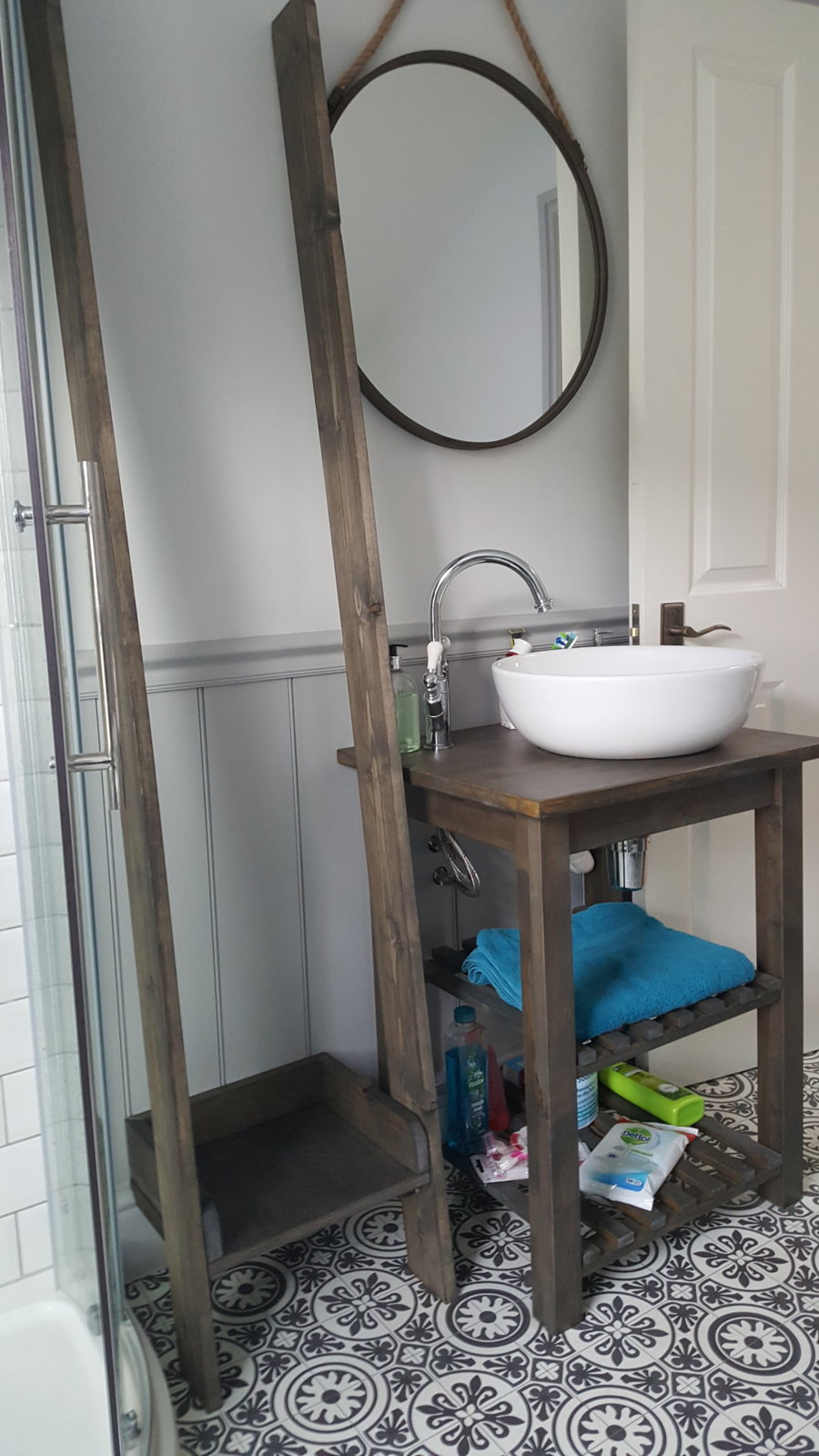

Our main problem was the space we had available for the shelves which is quite narrow.
I purchased some timber and got to work.

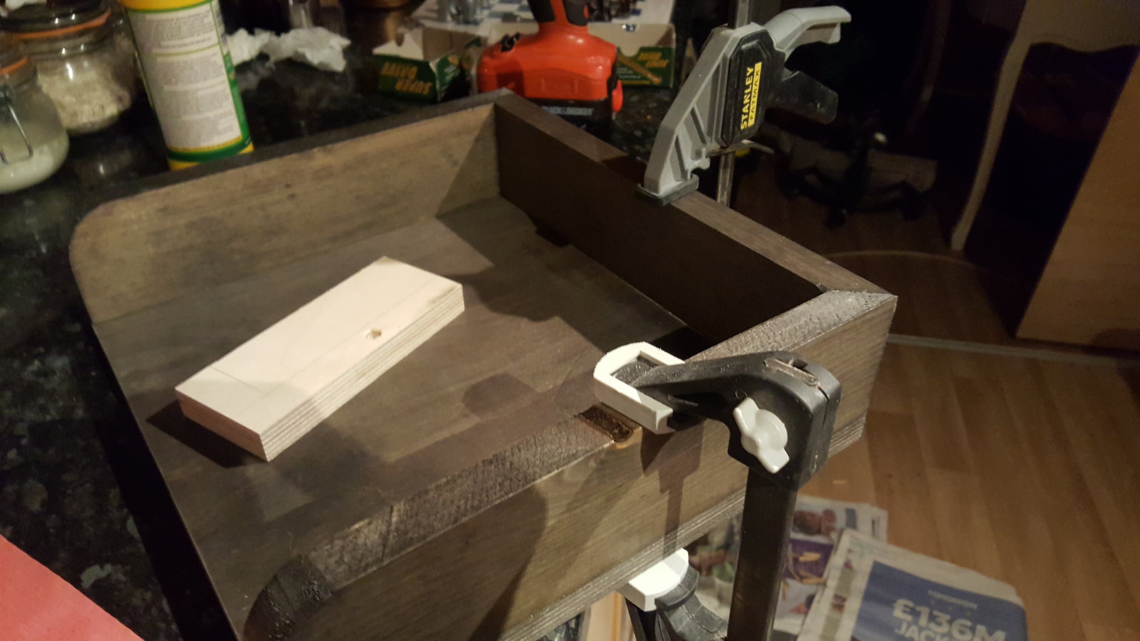

The shelf you can see at the bottom is held is resting on some inch by inch cuts. These are secured into the uprights and rest or 'hang' on the skirting boards. All good so far. The actual shelf is loose as it were.
My main dilemma is how I'm going to secure the remaining four shelves. They reduce in depth the higher they are on the ladder.
I'm thinking two screws into each side along with some PVA. The shelves when built are quite heavy (birchwood ply shelf with spruce sides). Would this be a secure enough method of fixing them? If I get them flush to the wall this should stop (or limit) any downward movement at the rear of the shelf. What do you think?

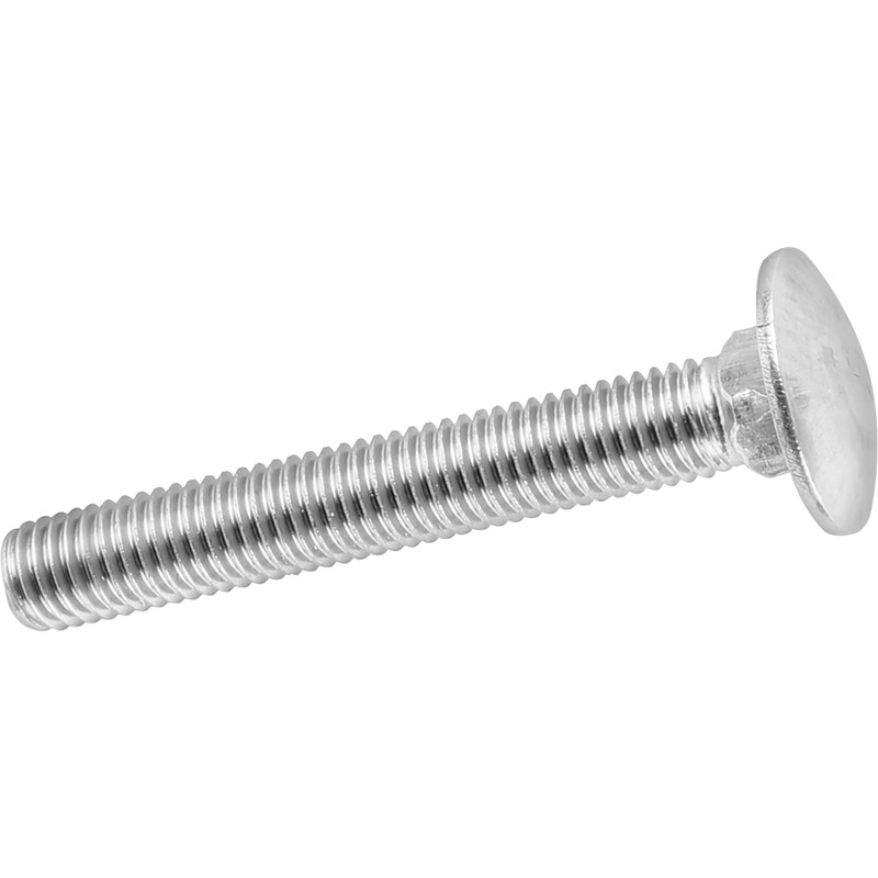

They look like heavy shelves :!:
You need to bolt through the upright and the shelf side,some wood glue on bare wood here will stiffen it up aswell.I would use M8 coach bolts (you may need to cut them to size) and dome head nuts inside the shelf.
Toolstation stock the nuts/dome bolts.

That’s right , keep it rock solid once tightened .
I've just noticed that these timber connectors are 50mm x 50mm. Is that not going to be a tad overkill for this application? Or is there no such thing? :) Also, they are M12. Would they still work with an M8 bolt?
