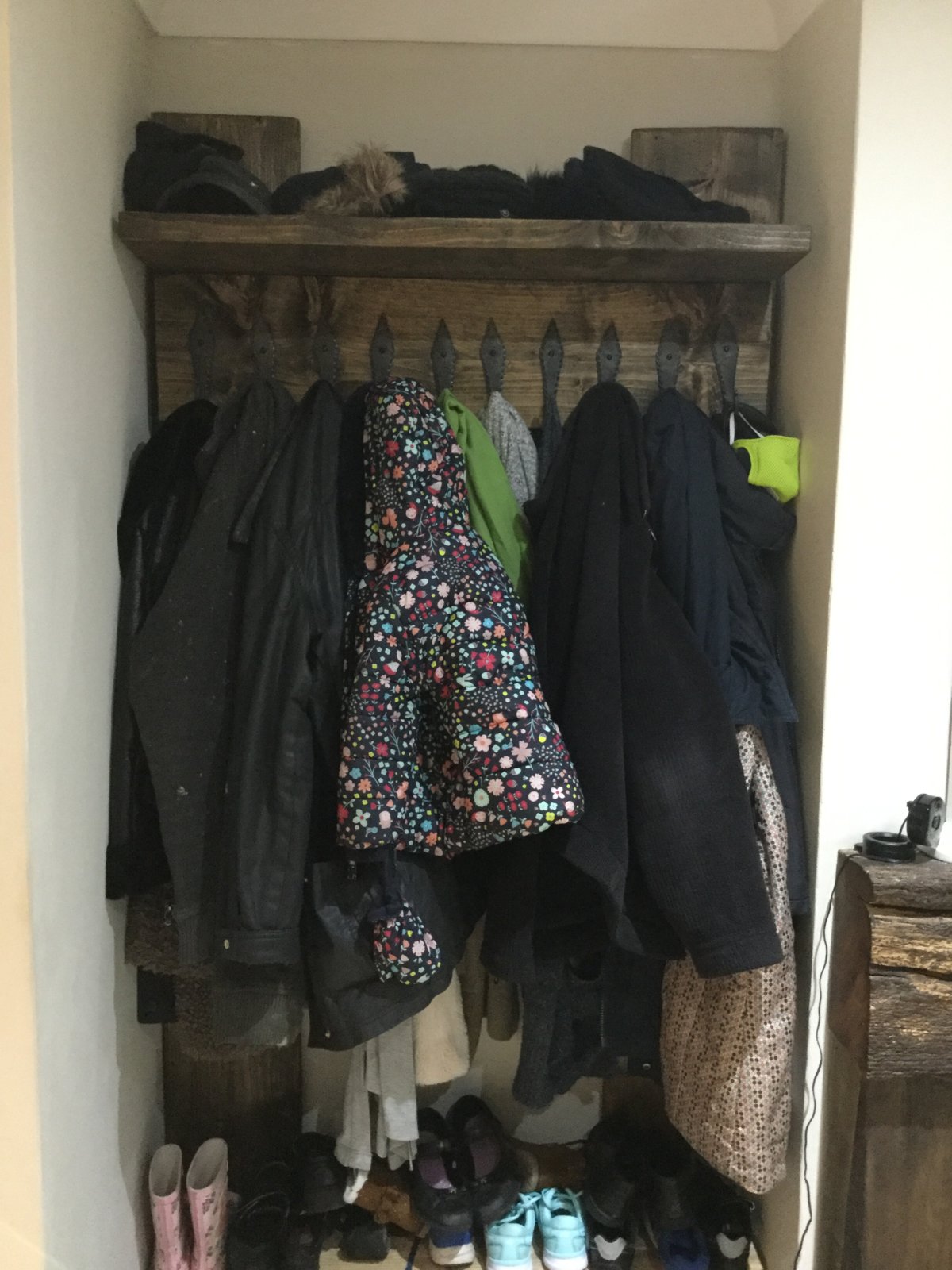

Used new scaffold boards[unbanded seconds] for hall coat stand/shelf unit, two vertical boards and screwed thru rear of these into shelf and then secured verticals to wall. Boards need storing indoors for a month or two as they can warp and split when drying . Used wood dye in danish oil to finish.
View attachment 134439 Used new scaffold boards[unbanded seconds] for hall coat stand/shelf unit, two vertical boards and screwed thru rear of these into shelf and then secured verticals to wall. Boards need storing indoors for a month or two as they can warp and split when drying . Used wood dye in danish oil to finish.
Looks good. Did you just store them flat on top of each other. I will probably stain with water based then use a couple of coats of danish oil.
