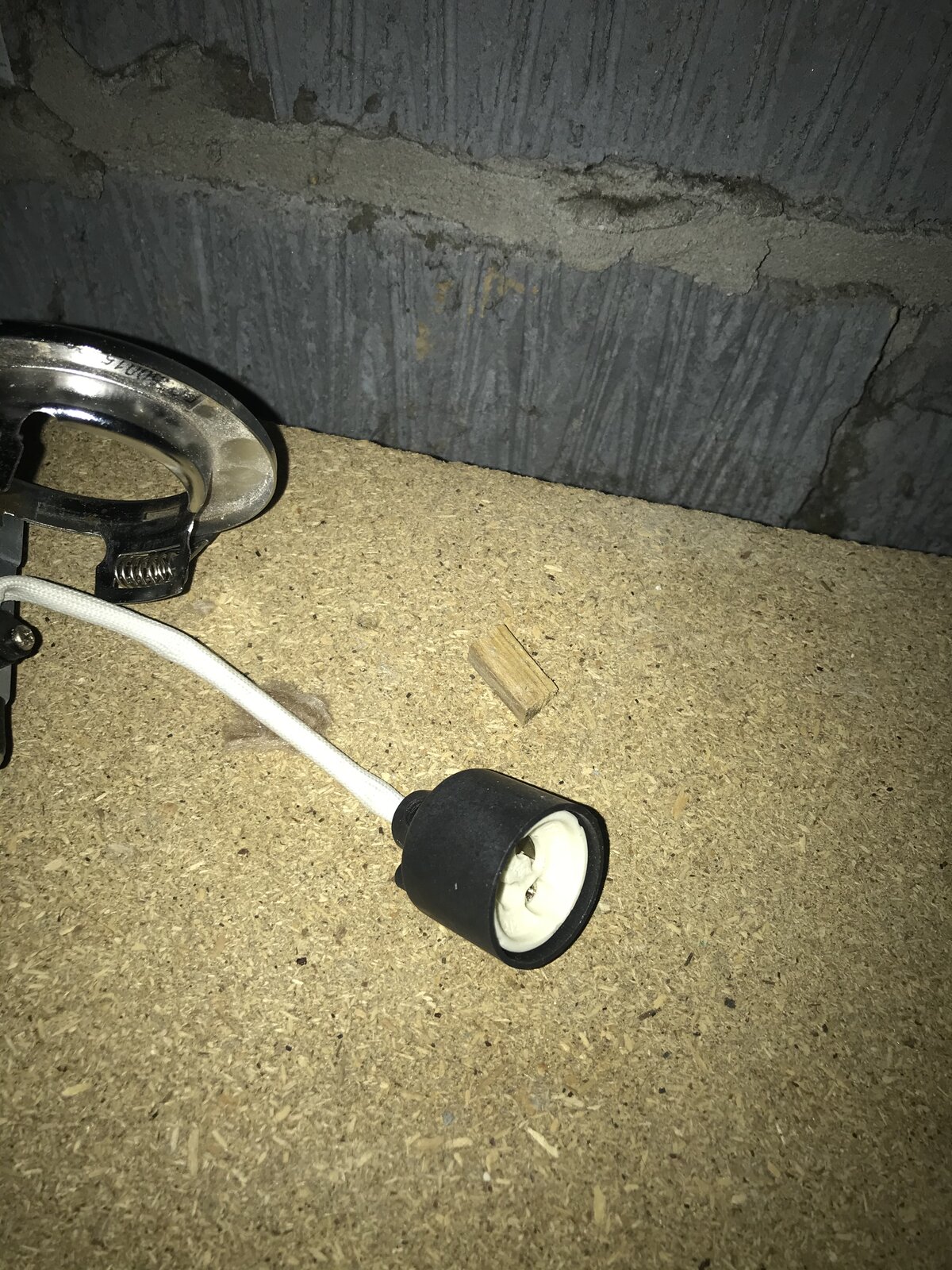

Update. Got my protective mask on and decided to move away loft insulation so I could get better vista of light configuration. Gist is my former spark is still alive and coming around to replace the halogens and transformers with LEDs.
However he isn’t available for two weeks. Wouldn’t be a problem, but.. In moving the insulation I disconnected some of the halogens from their connectors. Rectified that, but last light in circuit had different connection. (Attached) Is the bulb holder meant to connect to anything? Being thick but couldn’t see how halogen was connected, when I removed the retaining clip.
Only other thing is my “in line extractor fan”. Guy will probably replace when he comes up, but it now makes a racket when light switched on. (Comes on with lights and stays on for 5 mins) Would that be because the end isn’t wedged into the eaves? (Think that was way it was set up?)
