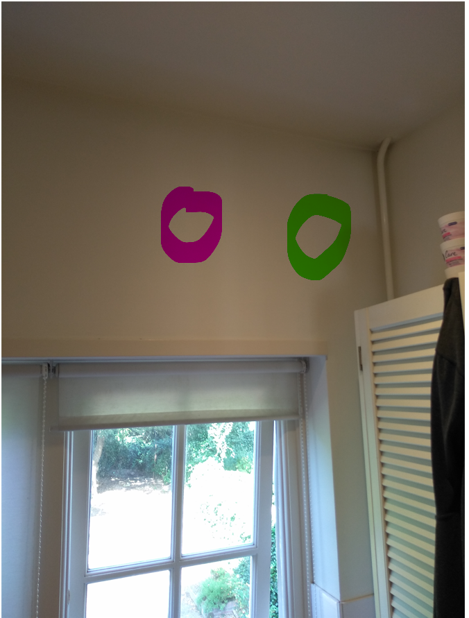

Hi, I need to open a ventilation hole in the wall of my bathroom to install a 4 inch ventilation fun. Structurally, since it is an external load bearing wall, what is the best place to make the opening?
Shall I do it above the window or in the corner? I attach a picture with the two options highlighted:
-red circle above the window
-green circle towards the corner
-any other thoughts?
I basically look for the more structurally sound place for the opening.

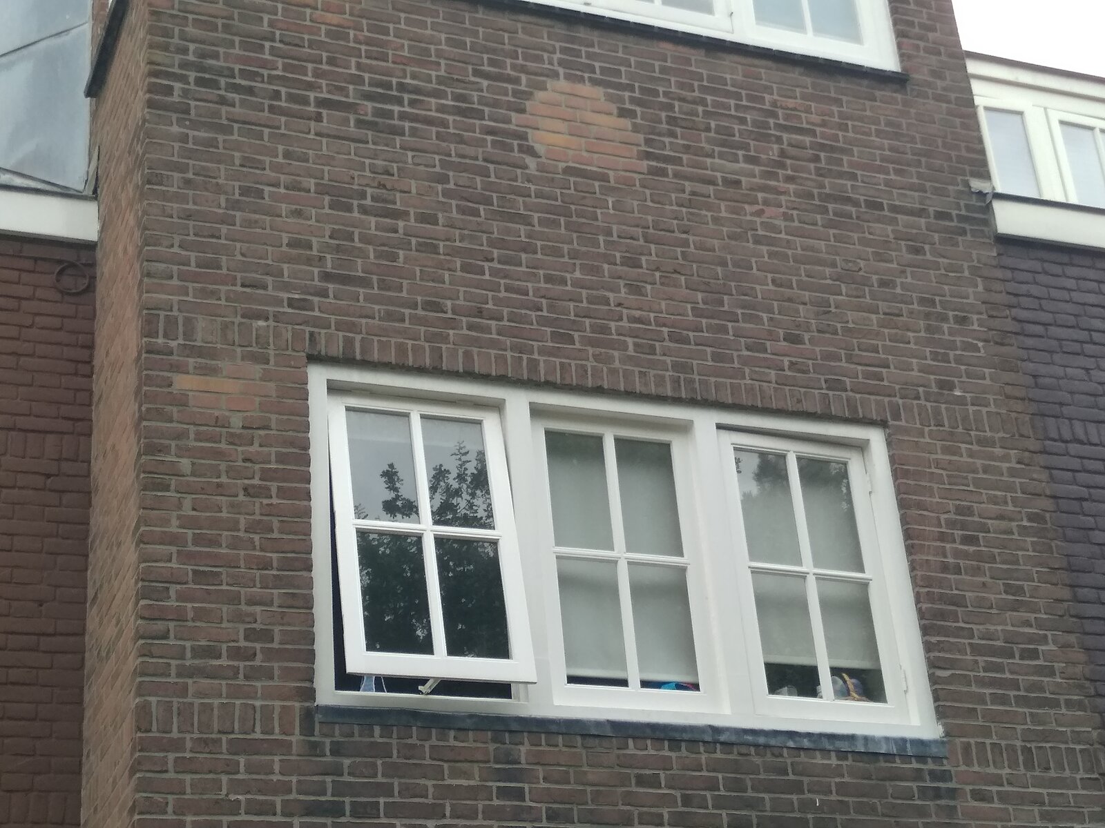

please show the outside wall.
if it is a gable with little brickwork above, it may be better to avoid the corner.
water vapour is lighter than air and rises to the ceiling, so the higher your fan, the better
Are you putting it above the bath or shower?
What is the ceiling height above the floor?

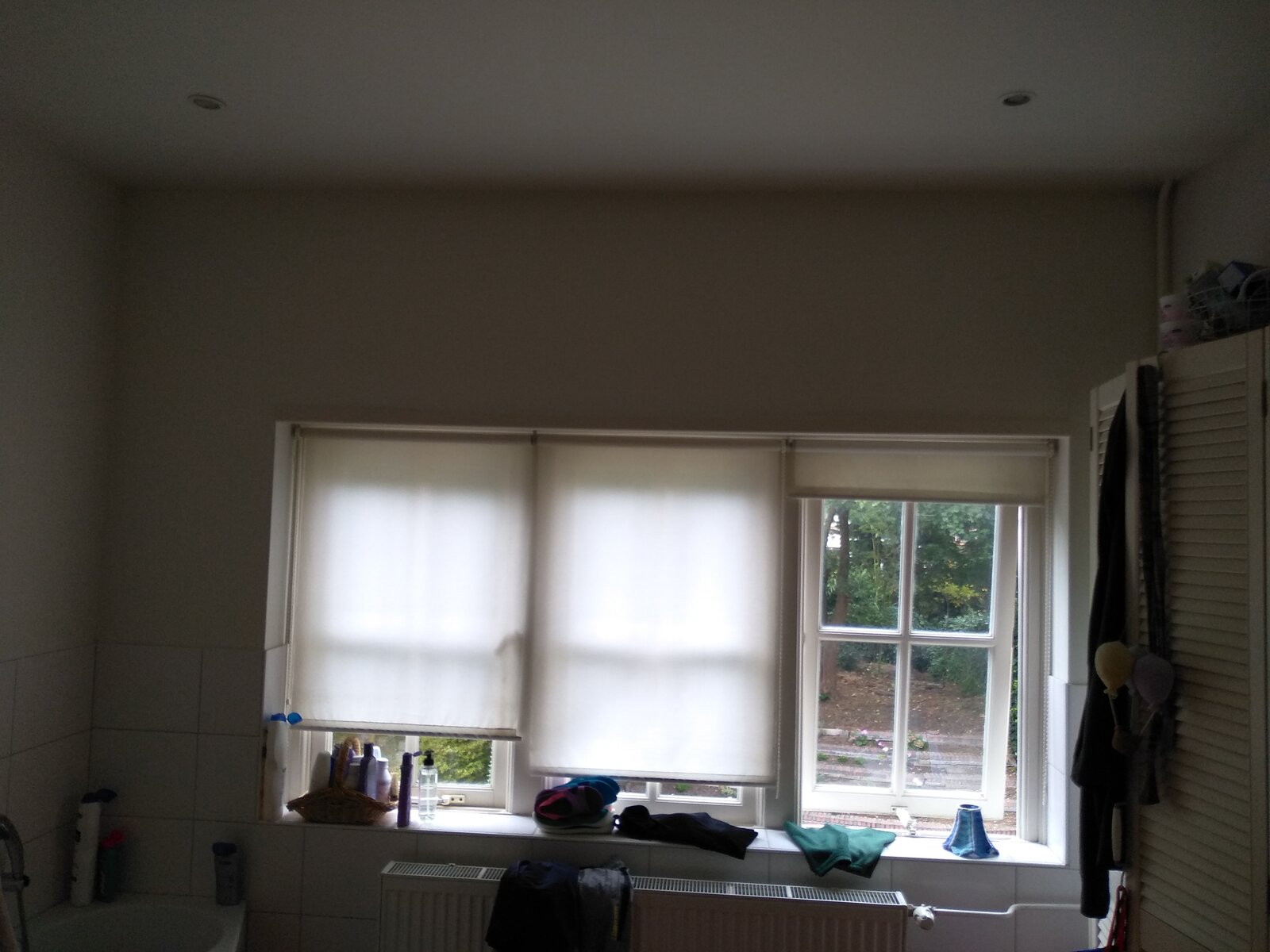

here are some pictures form the inside showing all the window and form the outside.
above there is another floor, with wooden joists.
The bathroom is in the other corner, but this corner it is closer to a wall with electricity and there are cabinets to hide the electric cables.
The ceiling has 3meters or about 10 feet height.

then the wall will be rigid enough
put it close to the ceiling
it looks like above you is another flat, so you will not want anything too noisy or intruding through the ceiling. If theirs is a bathroom, and/or they have a concrete floor, noise will not be such a nuisance.

Typically, room fans should where possible be placed 3/4 of the room height, 300mm in from any corner, and diagonally opposite/furthest corner away from the entrance door to the room
