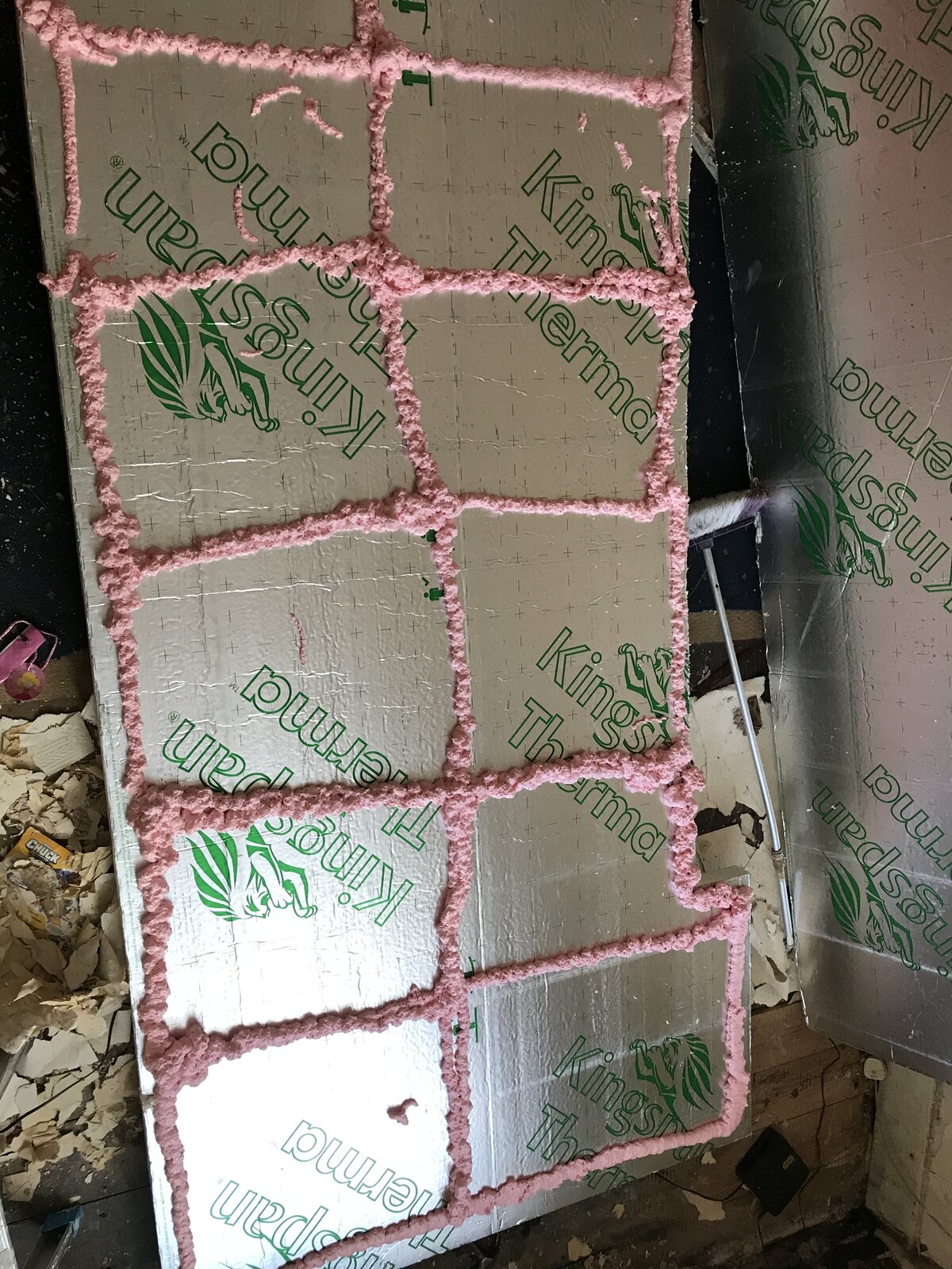

When sticking the Insulation Boards to the wall, do i need to use the foam adhesives or can I use gripfill? I am familiar with the latter and never used the foam stuff.
As per advice, I will also mechanically fix the boards to the wall.
I used foam - I think it gives a lot more coverage than gripfill - you spray it on, wait 4 minutes for it to cure a bit, then press onto the wall. If squashes and covers a larger area than a line of gripfill. Also better to foam if the walls are not perfectly flat.
My first insulation + boards have been up about 2 1/2 years now, still solid, still no mould at all. Everything good. But as mentioned, if the walls are damp from the outside, def. use mechanical fixings too. I used a couple on my boards too, just to be on the safe side. But I did a test, sticking a bit of plasterboard to a piece of wood with the everbuild pink foam, and I could not pull it off. Strong stuff.
I think that would be best - if you screw through unset foam it might stick to the drill bit.

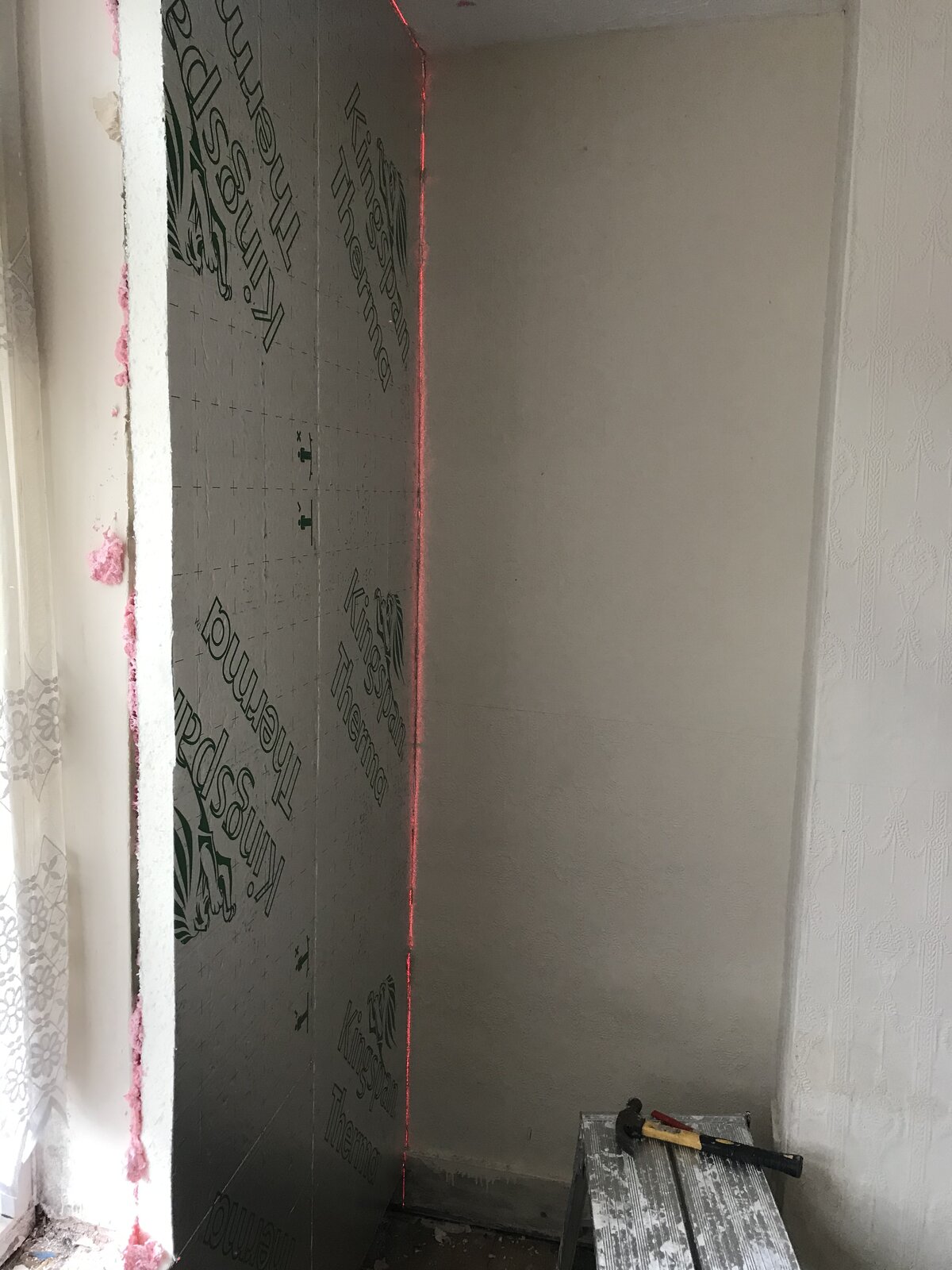

UPDATE: made good progress today. Got to use my new laser level for the first time. It was immensely helpful.

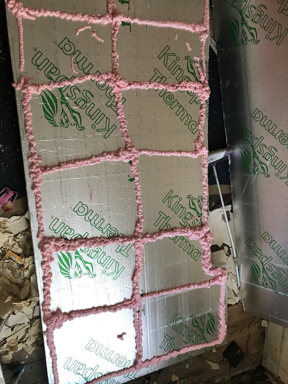

I ended up using a bottle of the foam adhesive on a single board! Does the foam seem excessive?
Can I use normal screws with flat washers to mechanically fix the insulation boards?
Good job, foam quantity is a little excessive, but I suppose it depends on how wonky the walls are.
Add a couple of fixings to the board as well, and it’s on for good.
Yes, but the insulation washers are concaved, so they don’t break through the boards when you tighten them.
From memory they are around £8 per 100.
It will be warm in there when you’ve finished !
I think I used one can for two boards on a rough wall, so you’ve been a bit over the top but not ridiculous.

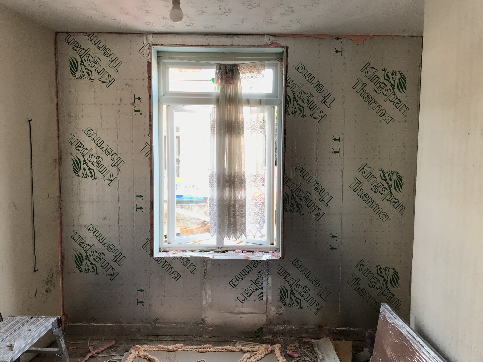

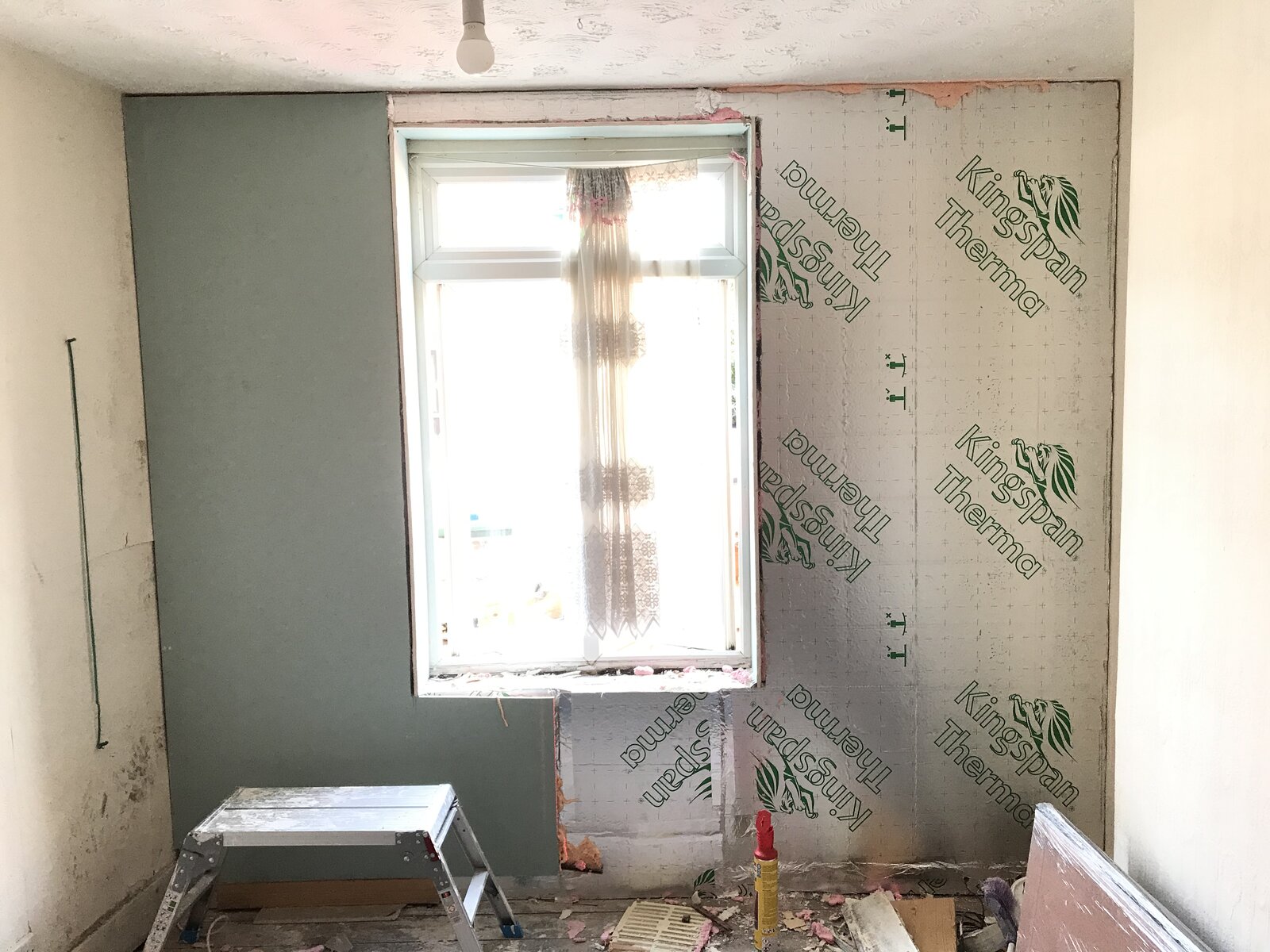

I decided not to drew the insulation. I’ve started fitting the boards and will then mechanically fix. This will take care of the plasterboard and the insulation.

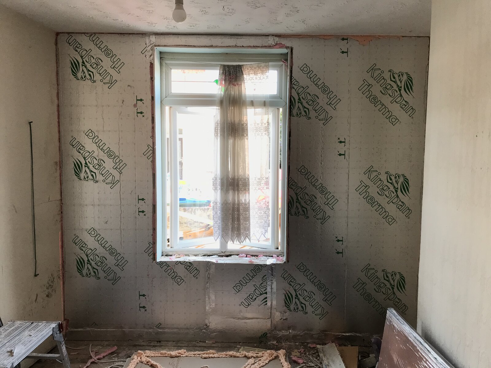

Is there any argument for starting the next board on the right of the wall rather than continuing from left to right? I was thinking that I could fit most of a full board on the right side. Am I then creating a problem with trying to adjust the level of the small section I would need to do in the centre...
I’d appreciate any advice on this matter.
