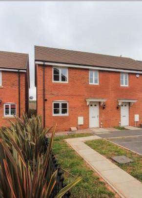

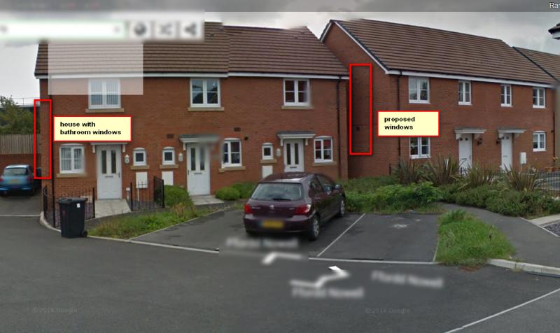

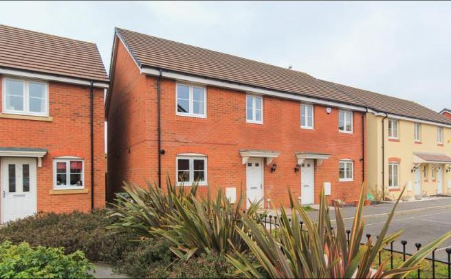

Hello,
We've got our eyes on a house but hasn't got bathroom windows, only extractor fans.
Can I ask if anyone knows if we could get permission to fit windows (obscure glazing) to an external wall as per pictures, please?
Haven't got a clue what the building regulations are and the council wouldn't tell us as it's not our property.
Many thanks in advance.

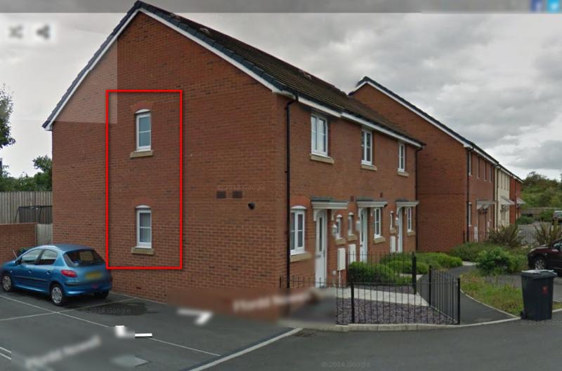

To be permitted development (ie not needing a specific planning permission), an upper-floor side-facing window has to be glazed in obscure glass, and have a top opener at least 1700mm above the floor.
But it is possible that the council has removed permitted development rights, and that planning permission would then be needed.
Aside from Planning issues, Building Regulations would restrict the area of such a window to 1 sq. m, as it is very close to the boundary (fire hazard).
