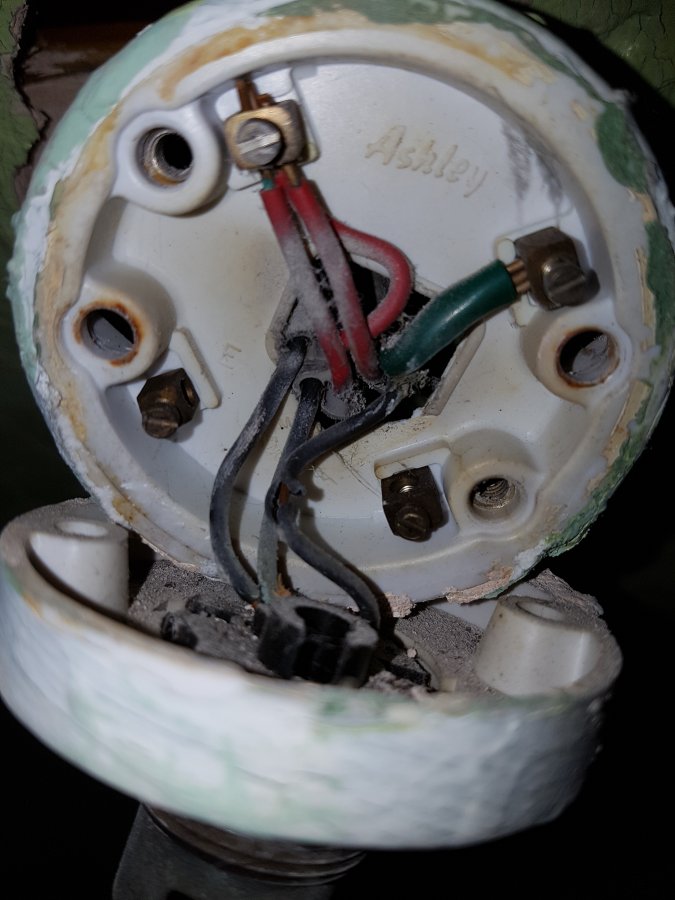

I'm helping my brother replace his bathroom. The ceiling rose had the below wiring with all the lives in one slot, the earths together in another and the neutral into a separate slot near the bulb.
He tried to replicate this with a modern ceiling rose and put all the lives in the L slots, the neutral in the N and the earths in the loop ( not the earth )
This melted the wire to the switch as this had a live and neutral through it instead of just the live and neutral becoming a live at the ceiling rose.
I'm guessing the earth did nothing as being in the loop section with no live it wasn't attached to anything.
I have bypassed the switch and wired the rose without it as if its a junction box but the upstairs lights still don't work. He has an old consumer unit and the fuses all look ok. Could any of the other wire in the loop have been damaged. The exposed parts all look fine and completely different to the wire to the switch.
The below picture is the original ceiling rose.

You have committed the number one most common mistake.
You need to wire it up as shown in the WIKI
//www.diynot.com/wiki/Electrics:Lighting-Circuit-layouts
On the new rose:
All the reds go into the LOOP
All the earths go into the EARTH
The two blacks that were together on the old rose go to the neutral
The black that was on its own on the old rose goes to the Live
EDIT: You may find that he has fried the switch and you'll need a new one.
If the wiring has melted as a result of incorrect connections, there is something very wrong with the installation - fuses should blow long before wires melt or even get hot.
You need an electrician. Remove the fuse(s) for the affected circuits and do not use them until the fault is repaired. Continuing to use the circuit is a fire risk.
Thanks. What fault would cause the fuse not to blow before the wire melted?
The fuse being of too high a value for the wire.
What size fuse or MCB is on that particular circuit?
For lighting circuit it should be 5 or 6 amps, but if he has rewireable fuses, then maybe some numpty has used the wrong fuse wire…….?
Any melted wire/ insulation needs replacing as a matter of urgency
And do you know why the wire melted and the fuses didn't blow? Sounds like something is seriously wrong
