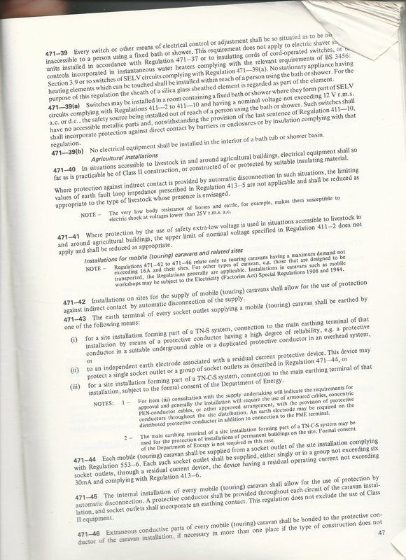

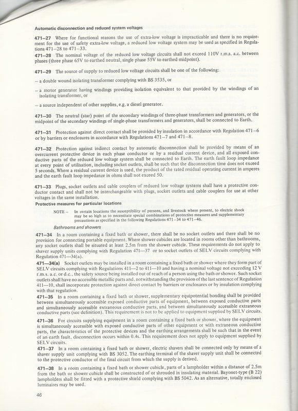

Anyone got a copy of 15th?! ... it presumably must have originated somewhere!
The 15th was not laid out like the 16th. there was no separate Chapter for special locations. Indeed, there were no zonal diagrams. Instead, provisions for bathrooms were listed in Chapter 47, Application of Protective Measures for Safety, under Section 471 - Protection against electric shock. Note the regs suggest livestock may be present in the bathroom...!
AFAIR, the "sink zone" was invented by a lighting manufacturer's association.
There are no measurements as such. But the gist of the 15th regs regarding the bathroom was "out of arm's reach".
SELV was OK within arm's reach as long as the source is out of arm's reach of a person using the bath or shower.
Every switch inaccessible to a person using the bath or shower, except shaver sockets, insulating cords of pull cord switches or controls of instantaneous water heaters to 3456.
No electrical equipment to be mounted inside the tub.
No stationary appliance having heating elements which can be touched shall be installed within reach of a person using the bath or shower.
Any light fitting within 2.5m of the bath or shower either had to be enclosed in insulating material or be an enclosed fitting. One popular method of compliance was to use a standard fitting (sometimes a batten lampholder but often a standard pendant) with a Home Office skirt.
FWIW, the 14th regs were almost identical.
