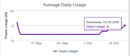

The Lidi battery charger failed, and mother had her other wheel chair altered so I could control from back, so battery forgotten until I had other battery charging problems and I found the sulphated battery does not gradually recover but it can sit for a week and do nothing then recover within 24 hours.
So two Lidi battery chargers replaced the failed one, needed one in a hurry when away with caravan hence two. Once the batteries I wanted were up and running again I thought may as well have another go at the 20 Ah battery, I had to put it in parallel with a 7 Ah to be able to connect it, and early June 2018 I tried to charge it, at first monitoring how it was doing, however it seems it was not to be, no wonder looking at age of this post.
However I did not take it off charge, and today it seems to have recovered, three months on charge and nothing, then over a few days it has recovered, as to how well I don't know, need to drag out the wheel chair so set it to run caravan lights, but it has laid unused for 5 years and it was not tip top then.
Did try powering caravan lights, with 5 lights on 11 volt, with 10 lights on dropped to 10 volt, however returning to 5 lights it ran for half an hour without the voltage dropping further, it would not run the wheel chair, but clearly would work anything with a low load. Returning it to charger 11.9 volts quickly rose, but held at the 0.8A charge rate to date so around an hour, it is clearly taking a charge.
It charged at 0.8A for around 2 hours, it then dropped to 0.1A, it has held at 13.8 volt all day yesterday no sign of either dropping or raising, however as to if there is any point is another question.
