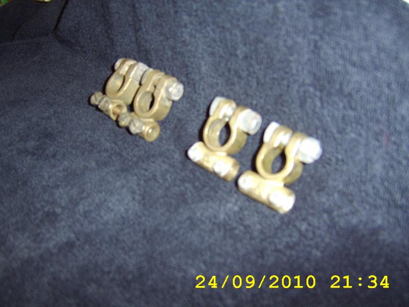

Hi Stivino. I'm actually completely lost now. I got the terminals that you have in your picture. Those are the ones I have. I previously bought a pack of Battery Terminal Adaptors AD1.
I have taken a photo of the 2 options I bought and have uploaded it here. Is there any way I can use either of these to fit to my battery terminal? I only need to change the positive one.
It seems like your Halfords adapter clamps could have worked here, after all.
Anyway.....you have two red leads going into the existing corroded clamp, right? Do you think, once you have cut off their ends and pared back the insulation, you could fit them both inside the new terminal with the 2 screws, i.e the one on the left of your last picture? That would be the best option, probably.

I think I have probably enough slack, but what I am unsure of is this:
1. Where do I cut? There seems to be 2 small units around these cables. It's a thick black wrapped cable. Inside this seems to be 2 smaller black wrapped cables. It's hard to see where they are going. None of the nuts and screws are coming undone. Not the one on the actual terminal and not the one that the cable seems to be under. I'm wondering can I cut the cable Before any of the terminal clamp/adapter comes into play?
2. Then, once I've done that, if it's workable, I'd have to peel back the 2Xcables. Does it then matter which side of the clamp I put each cable into, before tightening the screws around them and then fixing it to the terminal?
