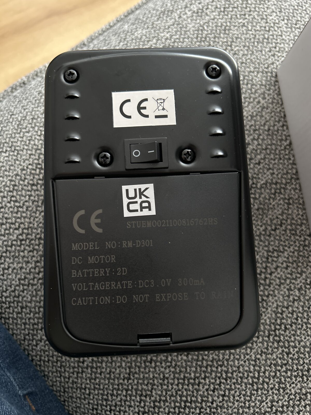

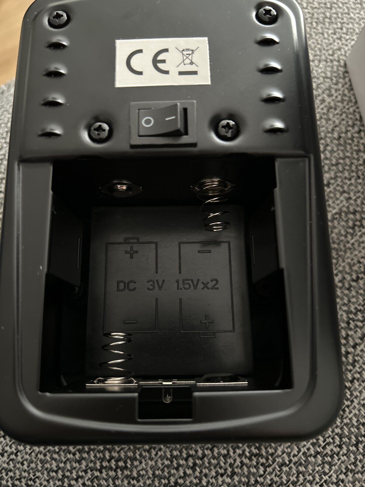

Good afternoon,
I have a rotisserie that is powered by 2 x 2D batteries, I would like to run it from a power bank.
I wouldn’t mind tinkering with it to get a good solution.
Could anyone offer a solution?
Thank you.
Devices like this exist...
I'm afraid I can't comment on their efficacy, but it seems to be rated at 1.0A at 3.00V, which should be sufficient for your 300mA draw.
A more permanent solution, would be to make a cut out and mount a USB socket, soldering on the connections - but at least this could be a proof of concept.

Thank you, I’ll take a look.
It may be simpler to use Rechargeable Cells and a charger, especially if you happen already to have a suitable charger.
Thank you FrodoOne. I’ve ordered the eliminator that RandomGrinch suggested as it was cheap and worth a try.
If that don’t work out, I’ll definitely be buying rechargeable batteries.
I do like the idea of soldering something maybe a jack port and connecting to a power bank so will look further.

I've made several of those for Christmas string lights. Connected to a smart socket. Standard USB voltage (5v) works fine for a 3 cell (4.5v) unit.
May be easier to buy one of the ebay ones for 2 cell items where the volt needs to be reduced to 3 volt.

Thank you, this came today and works great. Obviously the true test will be the battery drain.
eBay for a wall wart / mains adaptor that outputs 3v, and either
Take the panel off, and solder/crimp/ other connector to the internal wiring or
Cut pieces of dowel to the size of the batteries, and use these to squeeze the bare ends from the wall wart against the terminals as they are
If you are able to soldering, etc.. You could cut the end off a surplus USB lead, then connect two, maybe three 1N4000 diodes in series with the USB output, to drop the volts down to the 3v you need.

A silicon diode, forward biased, will drop around 0.6/0.7v at it's output. 5v -0.6, -0.6, -0.6v is around 3.2v, which is near enough, the voltage of your two cell in series.
So just solder the three diodes, to the 5v +ve of the USB supply, in series, each with the white bar, orientated with the white ring furthest away from the 5v positive.
5v+---->!---->!---->!----3.2v

Thank you Harry, where would I buy these diodes from? I cannot find them.
