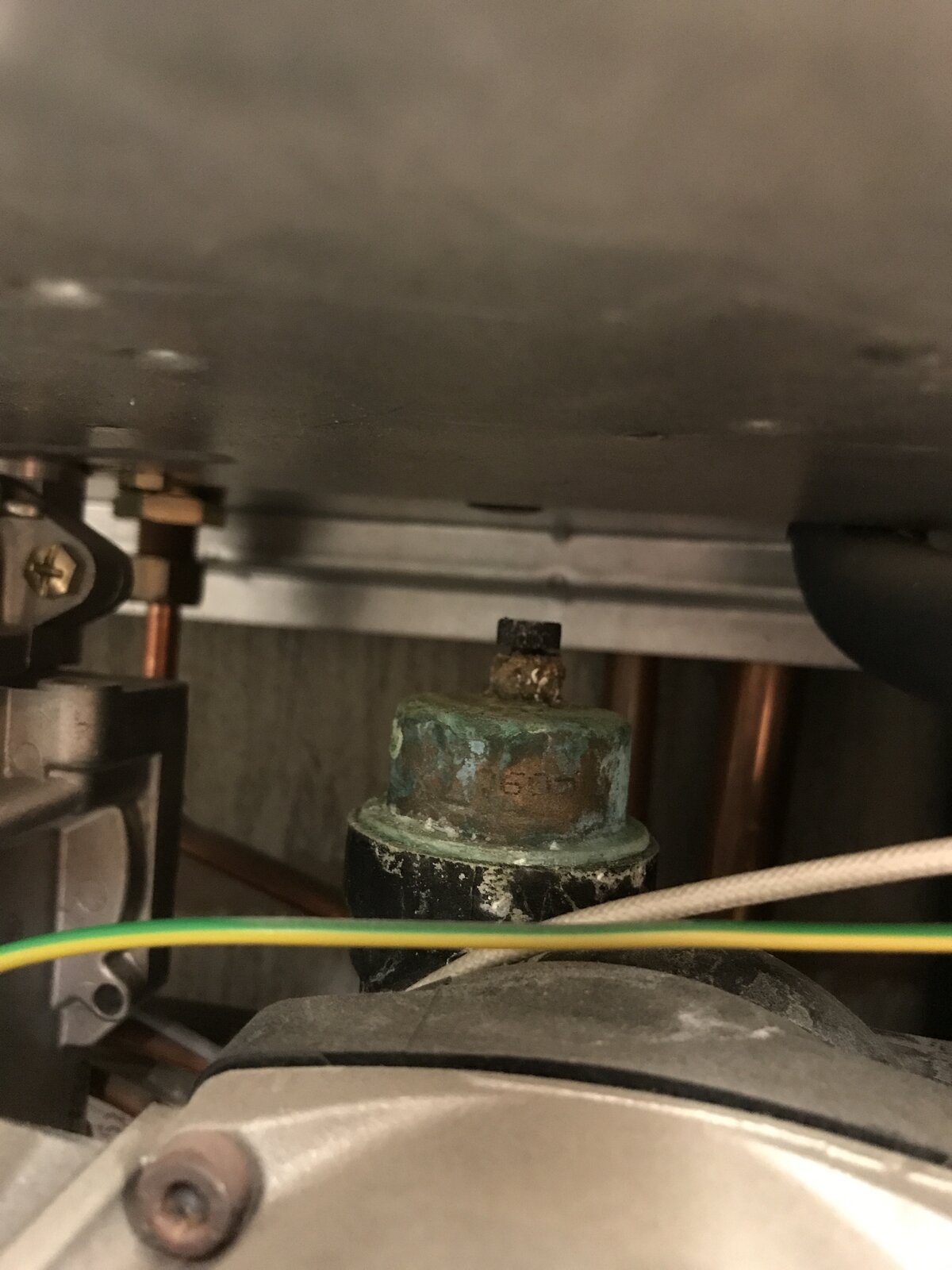

My Baxi 105e boiler has statred to make a whining noise when the heating is on and the pump is working.
I followed the advise of bleeding the pump (large screw on the front of the pump), I didn't hear and air come out but a small amount of water did. It took some time to stop the leek by screwing the screw both ways, but eventually it stopped.
The pump was very quiet for about 4 hours but then started again with the whining noise.
Does the pump need replacing or could there still be air in the system?
Thank you for taking the time to read through.
Andy

It is a tricky one, there could be air still trapped, but could also be the pump. Have you had to top the pressure up at all recently?
Hi Chris -
Yes, I've had to top the pressure of a bit over the past few weeks. From 1 to 1.5
In that case then, I’d rule out air first, as you’re adding oxygenated water every time you top up, plus the reason for topping up in the first place.

I've never touched the auto vent on the pump so I can't really say.
Where about on the pump is it?

What's actually whining?
The pump, the boiler, the pipework or something else?
Can you pinpoint it exactly to help the pros on here give more accurate advise?
You can take a video i think. Would help. :)

It's difficult to tell when the noise is actually coming from.
When I'm next to the boiler I can hear what sounds like a fairly high pitched whooshing sound.
It's loudest the furthest point away from the boiler, so the back bedroom.
It seems to get worse the higher the temperature of the central heating but it goes off if the hot tap is run.
Then comes back.
I've bled all radiators.
I'll try making a video this evening when the heating is on and post back tomorrow.

The auto sir vent in boilers should always be left very slightly loose so that they can operate an intended and remove trapped gas from the pump and system.
Certainly looks like it’s been leaking. Do you know the part number?
