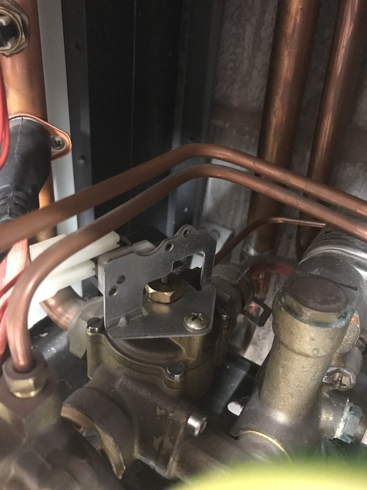

Never had to replace, its just little bits of plastic, takes a little time but nothing difficult, your video sounded like a by-pass problem, your boiler might or might not have one, is there a pipe comes out of the rear of the diverter valve or not
Just taken a photo of the diverter valve.
Just to clarify - the boiler is quiet when the central heating is initially turned on.
If the hot tap/shower is run, the boiler gets noisy when they're turned off and the central heating is still on.
Hope that makes sense.
Andy
