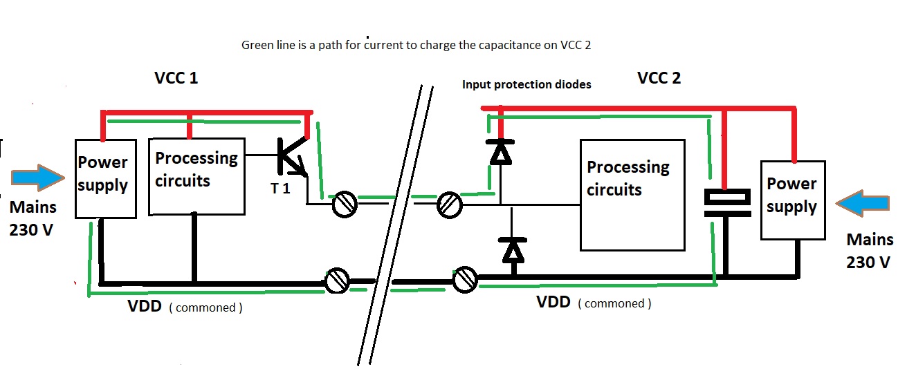

This may be a result of the Nest's 24 V (?) power supply turning on faster than the 24 V (?) supply in the boiler.
This diagram was drawn for a case where sensors ( VCC 1 ) connected to a data processing system ( VCC 2 ) were failing. ( modified for this post )
The transistors T1 in the sensors was going open circuit after a loss of mains.
It might be applicable to some of the cases of a Nest connected to a boiler
Consider VCC 1 as the Nest and VCC 2 as the boiler.
If the supply in the Nest reaches 24V before the power supply in the boiler reaches 24 V then the output(s) from the Nest might be powering the boiler's circuitry via protection diodes in the boilers PCB. This could damage the output devices in the Nest, ( T1 )
Bernard, checked before I replied to you post. Makes no sense on many levels when boiler and nest are concerned.
nest receiver supples power to the the thermostat. Receiver will only talk with the boiler by means of a relay contact that makes or breaks to start the boiler or disconnect the demand
nest will almost certainly not have a transformer power supply but a SMPS that is stable over a wide range of input voltages providing stable output voltage with feedback to the input for control of DC output which in many cases is voltage and current strapped.
A good SMPS should have all sorts of input voltage filtering and protection and would pop the fuse if something is not right. Check out this type of power supply, you will see what I am about.
There is no T1 but two relays instead
