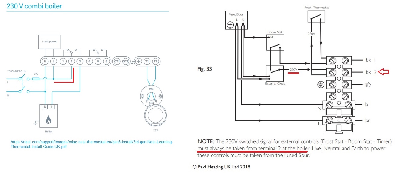

Back to possible reasons for the OP' problem of failing Nests
The installation guides for the Nest show the output as being able to switch either 24 or 230 volts depending on the boiler's control voltage.
There is a difference of opinion between Nest and Baxi about where the 230 volt control supply for the boiler should come from
A speculation is that if the Nest is wired as per the Nest diagram ( Live from supply ) then bk1 on the boiler could be supplied with 230 V AC when bk2 is not providing the control supply. 230 V on bk1 via the Nest without 230 V on bk2 could result result in higher than expected current through the relay contacts in the Nest.
Bernard, wiring the boiler like your example would make some of the circuitry within the boiler live when 2 pole isolator on the control panel in in the off position.
Furthermore, a lot of boilers are addressed to run or not via optoisolator, current for which is about 20ma at 2 volts input
nest wiring shown would almost certainly be used on a heat only boiler where motorised valves are employed. It is not the first time had to replace a pcb where a 240 volt demand was applied to a boiler that required voltage free switching. Nest and hive are fast becoming fashion controllers where the end users are self fitting not then confusion takes hold when looking at multiple terminals
Almost everyday there is a wiring query in plumbing section where an end user is seeking advice given free of charge by regulars like Stem and other professionals
I suspect Baxis wiring diagram is more from a point of view of compliance with the Electricity at Work Act and safe working procedures when working on boilers.
Those regs require checking the absence of 240V between the L,N & E terminals. Clearly bodged wiring (say a boiler & controls fed from 2 voltage sources) would not be picked up by those tests,
so to mitigate that circumstance perhaps they insisit on the controls Live feed coming direct from the boiler terminal block.
Now of course many timeclocks feed their relay commons from the Live within the timeclock so would not be suitable
The whole situations a shambles but that's to be expected from the boiler industry.
In the absence of 230 V on boiler terminal bk 2 it might be that the 230 V being fed onto terminal bk 1 from the Nest is supplying several parts of the boiler normally supplied from the boiler's own power system. This abnormal load might be enough to over stress the relay contacts in the Nest.
