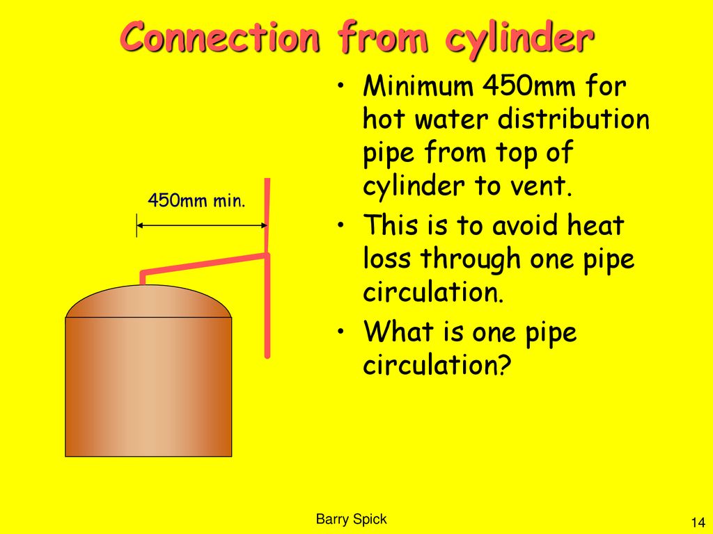

One pipe above your hot water cylinder (the draw off pipe) can lose a lot of heat due to 'single pipe circulation'. Ensure this pipe is well insulated.
