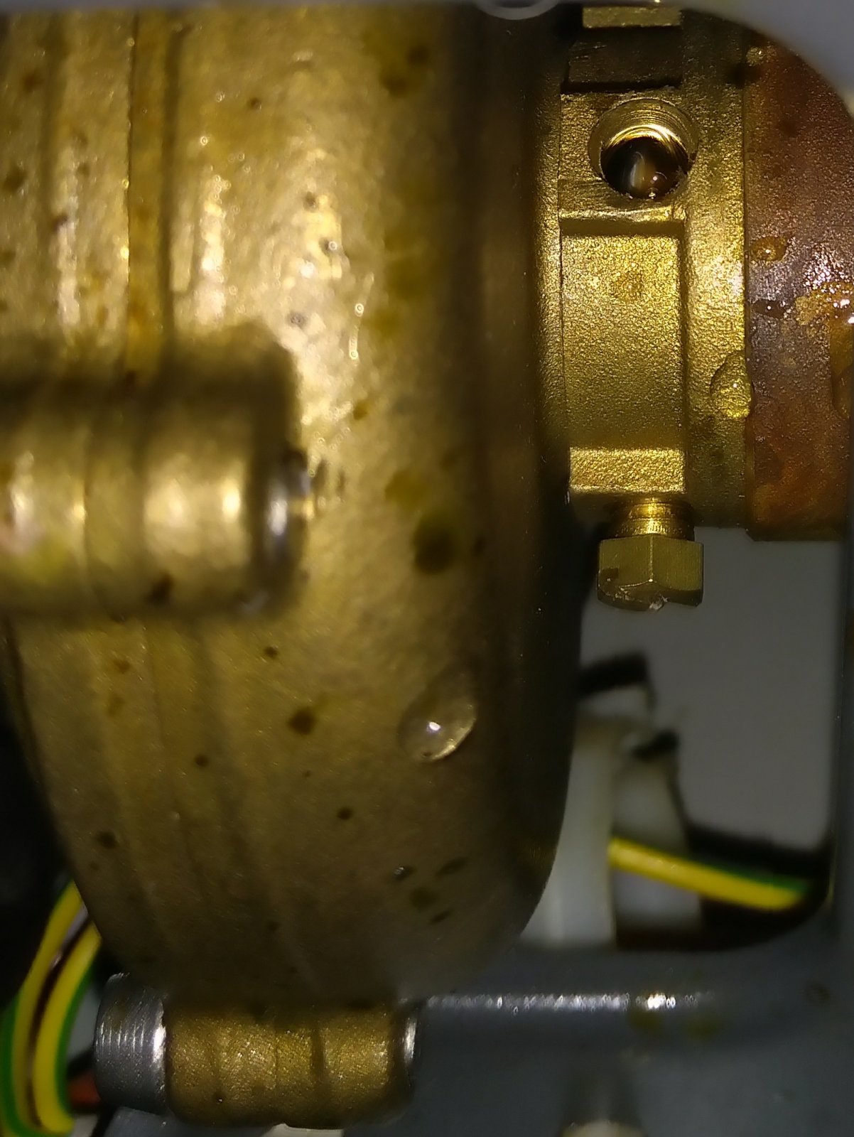

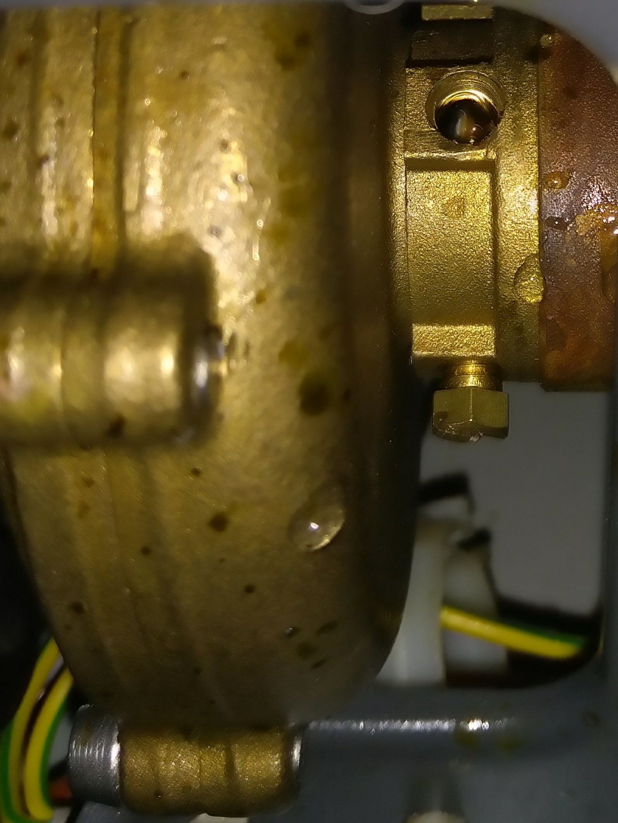

Got a problem, there is a slight leak coming from the rear of the diverter valve, the bottom screw is tight but it appears to be coming from the hole in the middle, I thought maybe a screw got loose, but it doesn't look threaded
Any ideas?
Removed the complete brass diverter assembly, fitted the small O ring at the back of the rear spindle, although there wasn't one fiited, all seems well now...
