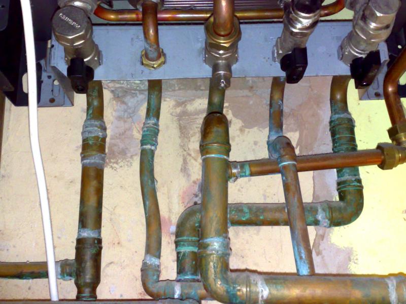

Hi, I've got a Baxi Combi 80e, i was trying to increase the pressure and is not working, the heating works and the hw too but because the pressure was about 0.6 i was trying to increase it, so when the radiators were red hot i was triying to increase it, i turned the black knob but the pressure is not going up and yea you can tell than is open but i left about an hour and the pressure didn't move at all.

Picture would not go amiss

send us a picture

Are you sure your not just turning off one of the flow/return/cold mains isolators instead of the filling loop?

As you look at it the two valves on the right are where any 'integral filling loop' would be fitted. As the valves bend up into the boiler the loop part comes from the front of each valve and is looped to the left either with a conventional looking silver braided filling loop or a more discreet copper loop with valves.
From what you tell us the filling loop is not an integral one so you must look elsewhere for it or post a picture taken from under the boiler looking up at a 45º angle so we can confirm whether or not its there.
combi 80e does not have a built in fill loop .trace the pipework away from the boiler and look for a conection across heating rtn and cold water pipe.
From the Manufacturers Instructions Page 11
. There are connection points on the mains cold water inlet and central heating return isolating taps Fig. 4a) to which the optional filling loop kit (Part No. 248221) can be assembled.
I am all for care in the community but looking at that picture its taking it a bit far allowing the blind to pipe up boilers :eek: .
To OP you dont want to be touching any of those black knobs as they will not pressurise your boiler . you want to be looking further along the pipework for probably a washing machine hose attached to heating pipes (looking at the standard of them).
