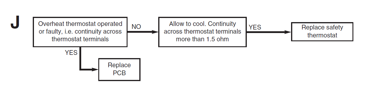

I replaced the venturi and diverter valve diaphragm with no problems, switched it back on...and now it won't fire up at all. :mad:
It's flashing "Flame Fault" and "Safety Thermostat" now.
Safety thermostat is not tripped (i.e. the contact is closed) and the wire from the PCB to the safety thermostat is buzzes out. Tried linking-out the terminals on the PCB just in case, but no change.
Wire between the PCB and the igniter also buzzes out but I can't see any attempt to fire it. Is this is locked-out because of the safety thermostat error?

You have got water on the pcb . turn power off take cover off pcb and dry with a hair dryer
Yeah, that's what I thought initially. I've taken the PCB out and it's not wet at all. I will give it a try though, just in case there's some water under a component anywhere.

Safety stat normally closed would seem to be correct but this seems to contradict it?.
Well..I'll..be..dipped! :D
Left the PCB for a while and then ran the hairdryer over it for a few minutes. Didn't see any water running out, but blow me if it didn't pop back into life when I put it back in.
The venturi/diaphragm seems to have helped enormously. I can run the downstairs cold full on and still have hot upstairs now.
