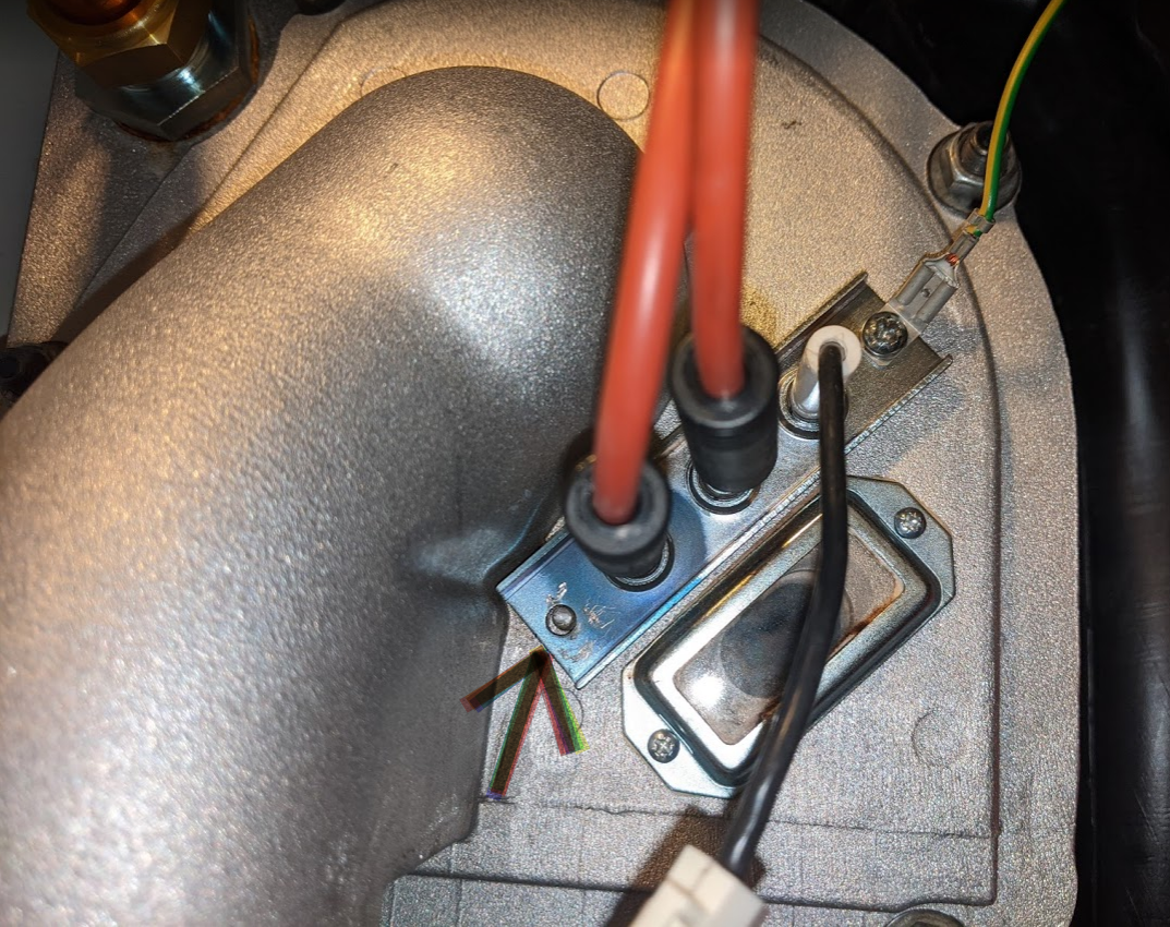

Had an engineer to come out and do a service, when he opened it up he noticed that a screw was broken on the burner heat exchanger (see the picture, arrow pointing to broken screw)
He said he could fix it but it would cost an extra £50 because the threads must be knackered in the housing. Alternatively he said to leave it and it would be OK because the hole is actually filled with the broken screw. I told him to leave it to save a few bob.
However, just looking for a second opinion. Does anyone know about this kinda stuff?
It needs sorting...if the seal behind the electrode plate fails the boiler will become toast..new boiler time normally as 1000 degree combustion products re-circulate back into the fan.
£50 to guarantee a fix is odd...how can he know the broken screw is removable and the thread ok?
A new burner door part is around £60 - £70 + fitting.

OMG that could get very expensive! He didn't actually mention the word guarantee.. I imagine if it didn't work he would have said 'bad news, you're gonna have to stump up more cash for a new part!'
How dangerous do you think it is as is? Should we stop using the boiler until it's fixed?
The picture doesn't seem to indicate the gasket is leaking, but get it fixed asap.

It looks as if the screw head has been sheared off and there is some thread poking up above the plate it is supposed to retain. It would need a second photo from the side of the screw, to confirm that, but if that is the case....
Maybe you could find a nut to screw onto the bit of thread?
Maybe you could get a grip of the piece of thread and simply screw it out and fit a new screw to replace it, using a Mole self grip wrench.
It seems very odd to me, that the screw head became broken at all, perhaps it was an original production fault from when the boiler was built?

Quite common to happen, sometimes easy enough to get the sheared screw out, but sometimes a total ball ache, never had one I couldnt get out, but yes you should get it sorted, could cause expensive damage to your boiler

Update on that, the RGI came out with a spare door but tried extracting the screw first.. that didn't go to plan, replaced the whole 'door' in the end. Cost me £120 in total :cry:

Ouch, last one I had it was me that sheared the head, so had to take it on the chin. two hours to get the stub out and couldnt charge as it was me that snapped it in the first place, so much heat in there these things virtually weld themselves in there
stainless screw in a stainless nut or casting is liable to cold-weld (this is not caused by heat). You can get an anti-seize spray to use during assembly. If it has seized it will need destructive removal, you can't free it. a boron drill will work.
stainless screw in an aluminium casting will corrode. You can use a nickel grease up to 1450C. It is quite expensive but sometimes sold in 25g or 50g packs. Copper grease is unsuitable for alumium as it accelerates corrosion. Ceramic grease is very heat resistant though
