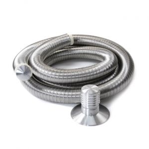

yep that is the one , it is connected at the back boiler and is jointless to the terminal at the top of the chimney, nothing that can be swept.

The fire must be removed so that the integrity of the flue liner (a flexible tube from top to bottom) can be checked and that it is secured to the back boiler flue outlet and is clear.
The redundant back boiler must be checked for correct decommissioning.
Any old pipe holes etc. in the chimney breast must be sealed up.
Ideally the gap between the flue liner and masonry should be sealed.
The liner must be terminated with the appropriate terminal (normally circular and aluminium) where it emerges from the chimney on the roof.
If necessary the fire ventilation requirement should be checked.
The flue integrity must be checked with a smoke pellet (say by placing it on a tray just below the liner), and whilst it is burning the entire chimney is checked for any escape of
smoke (including the roof space) and for the smoke to only emerge from the liner terminal. It is sometimes necessary to warm the flue with a blowlamp beforehand to help the draw.

Your back boiler is still in situ but de-commisioned, the boiler has a flue liner , it will not be blocked, they are talking total rubbish, you dont sweep a liner
TBF, Ian, it wont be blocked in the traditional sense, but it COULD be full of cobwebs, killing the flue.
In this case, though, it is clear that the "RGI" has not a clue about BBU/fires, and is more likely to be a misdiagnosis.
Cobwebs are probably more of an issue on a fire with a decommissioned BBU, as the flue would be unused for months on end, rather than a (normally) daily firing for a BBU
