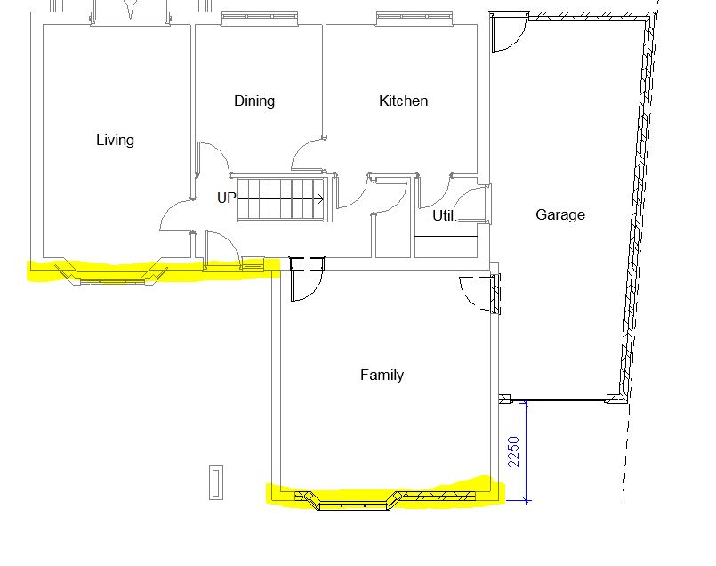

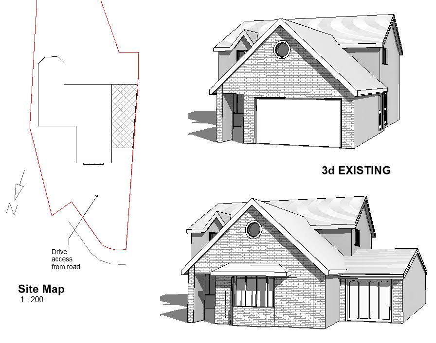

Hello,
I want to apply for a Lawful Development Certificate for this project. I'm looking for some advice. I'm confident(?) that the garage being less than half the house width and less than 4m high will be OK, but I'm not so sure about the proposed bay window where the existing garage door is to be infilled. Would a bay window with brick base need planning? What if it was a bay window without a base? Could I have just the window with a canopy over? Or being the principal building line, can this only be a flat window?
Mike
If any part of the window projects - whether supported by a wall or not - it would need planning permission. The rules describe it as an 'enlargement' rather than an extension, and any enlargement forward of the front wall needs P.P.

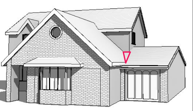

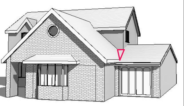

If one really wanted to be pedantic they might argue the red bit on this image was a projection beyond the front wall.
Well I was being pedantic.
Tony, do you think it could also fall foul of the 'extending beyond a roof face on a principal elevation' rule?
Wouldn't that only apply to a (Part B) roof enlargement - specifically a dormer on the front?
With regard to projecting eaves - they don't take them into account when allowing 3m/4m extensions on the back, so by extension (no pun intended) I wouldn't have thought projecting eaves on the front would be caught out?
With regard to the OPs proposed bay; if it was mine I'd just build it and not worry the council about it. As long as Building Control is sorted, it's not going to be a big issue. What I wouldn't do is apply for a LDC - they won't give one so it would be a waste of time and money. Either build it and keep schtum, or apply for planning permission.
Thanks All. Based on what I've read here, I am going to get rid og the bay and just have a window. Regarding the 'triangle'. I am going to hope they allow it under LDC. I will let you know the outcome.

I think the bay window will help to soften that rather stark front gable. Unless there are some special local circumstances I would be surprised if a planning application was not successful. (although the roof to the bay needs some work as it is rather top heavy)
