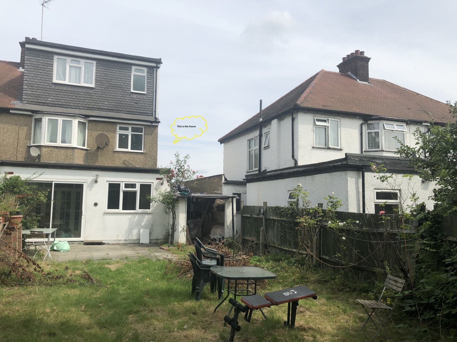

- a good reason not to allow loft extensions as permitted development ,and many other extensionsGood God that's horrific,
Christ on a bike! That's awful. It's enough to make Chris Wren weep.
'If thine eye offends thee, pluck it out'Christ on a bike! That's awful. It's enough to make Chris Wren weep.
It's called the planning process Would you just let anybody build whatever they wanted whatever it might look like - oh ,yes , sorry I forgot ,you would Tonythey enjoy their little power trips of telling people what they can and can't have - it's called The Public Sector.
I agree it doesn't look good, but people need the space, and children should not be confined to rabbit-hutch housing.It's called the planning process Would you just let anybody build whatever they wanted whatever it might look like - oh ,yes , sorry I forgot ,you would Tony
- but they don't have to be hideous ,that's where design comes in , just some consideration for the appearance would help.J.B.Priestly wrote: " we should be content to make the country hideous if all the people in it were tolerably-well housed".
