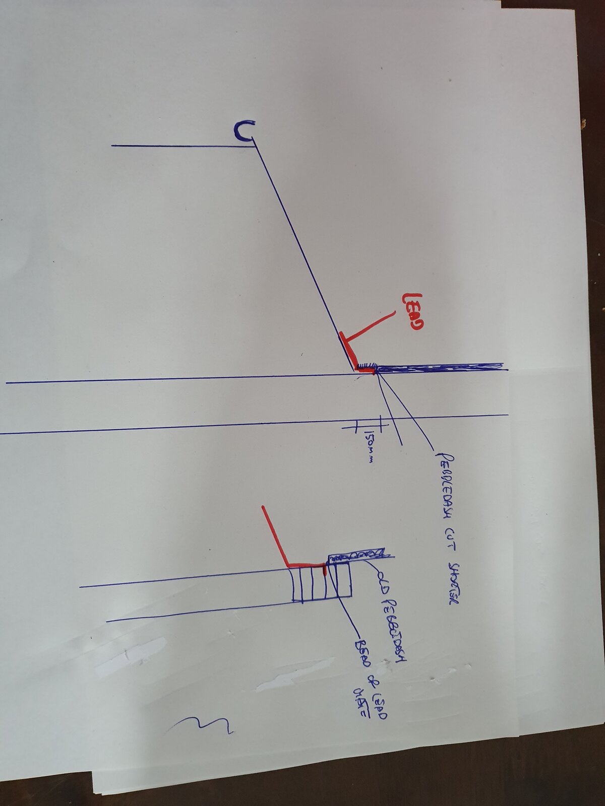

Just to recap.
I'm keen to remove the existing crap job and make it from scratch.
My plan is to order new code 4 300mm lead and drip beading.
Today it's raining but when will be dry I was thinking to remove the old lead and crappy mortar repair. put the new lead am maximum 1500mm lenght and overlap 100 each other. Push the lead inside the wall to touch the bricks and nail it down. Then install the drip bead and redone the render trying o match the pebbledash as at moment look crap.
Would you do something different? any tips is welcomed as always.

It needs an upstand of (ideally) 150mm, though a wee bit less is ok and then chasing into the mortar joint (25mm), clipping and sealing with Leadmate and the bead locating so that it overhangs the joint.
Would this be a clean job? Completely different to what they have done previously.
Please advise if not understanding it wrong.
my other neighbour also have mortar coming down to the bottom end but not sure the part on top of the lead how is holding together.
Apologies fir the stupid questions but never done this before. Want make a decent and long lasting job.

It does not need a 150 upstand as its a sloped roof and rendered, so it could go back at the same level. There's no need to create extra work.
It does need tidying up, and be aware of all the usual requirements - deep enough clean chase, suitable plugging for fixing the lead, suitable code of lead, max lengths of single piece plus minimum overlap.
If you want bonus points, fit a render stop/bellcast bead above the lead.
I got code 4 300mm wide lead and stainless stop beading. I was not sure how to fix the lead and beading to the wall. Shall I use standard wall plug and screw to fix the lead and beading to the wall or there is something more specific?
About overlapping other member suggested maximum 1500mm and minium 100mm overlapp.
I'm getting there if can sort out how to fix it to the wall
