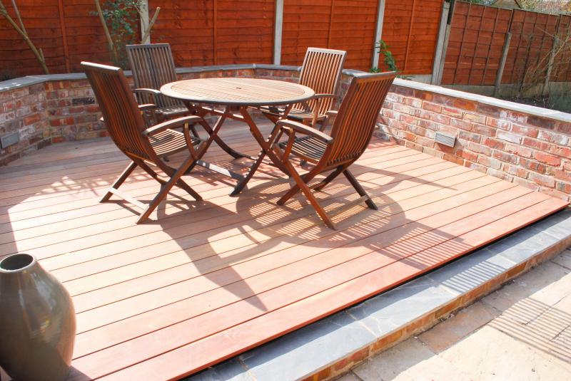

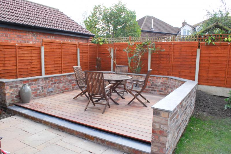

It's finally finished, I dug out the soil at the rear of the wall and installed a french drain to direct the water away. The rear of the wall was also sealed with bitumen and a waterproof membrane which has made it a lot drier - no wet mortar is noticeable at all now.

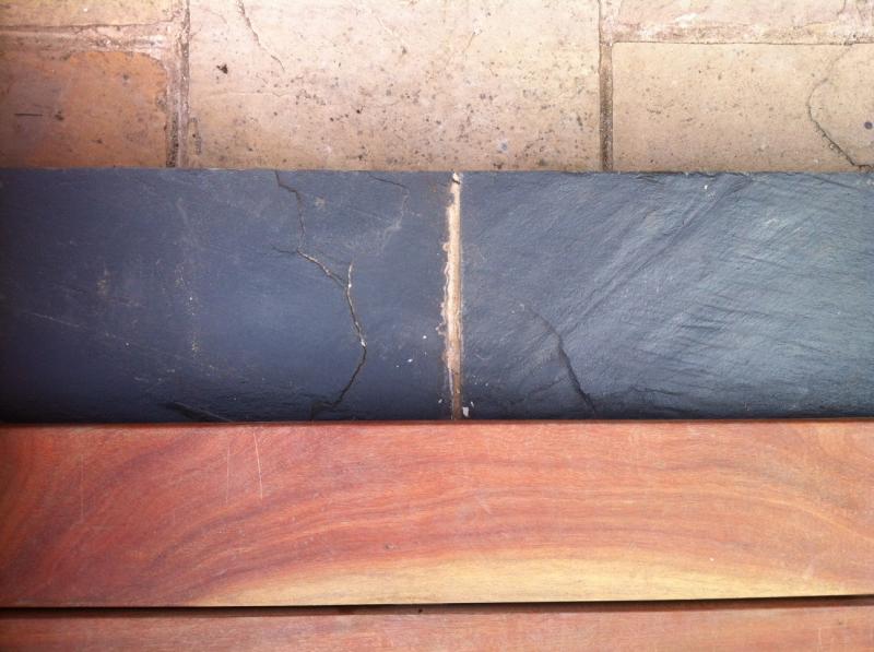

If anyone can recommend a slate sealer that gives a 'wet look' then please let me know

.....as an aside, I went for the Lithofin Slate sealer which has done the job. It will probably need re-applying every year but it brings out the beautiful colour of the slate.

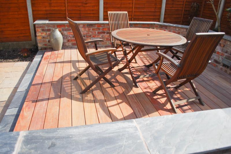

Ok so I thought I'd post an update in case anyone is wondering about durability or how hardwood decking stands up to the elements.
Well safe to say I haven't had a problem with it, even in winter it doesn't get slippery. In early spring I (contrary to what someone posted earlier on) powerhose the decking and give it a coat of sealer which makes it look like new. The original depth of color has obviously faded with the UV exposure but I like the silvery tone it has acquired.
If I was to give any advice on this project I would simply say to save up and go the extra mile when it comes to the quality of wood you use, it really does make a difference.
