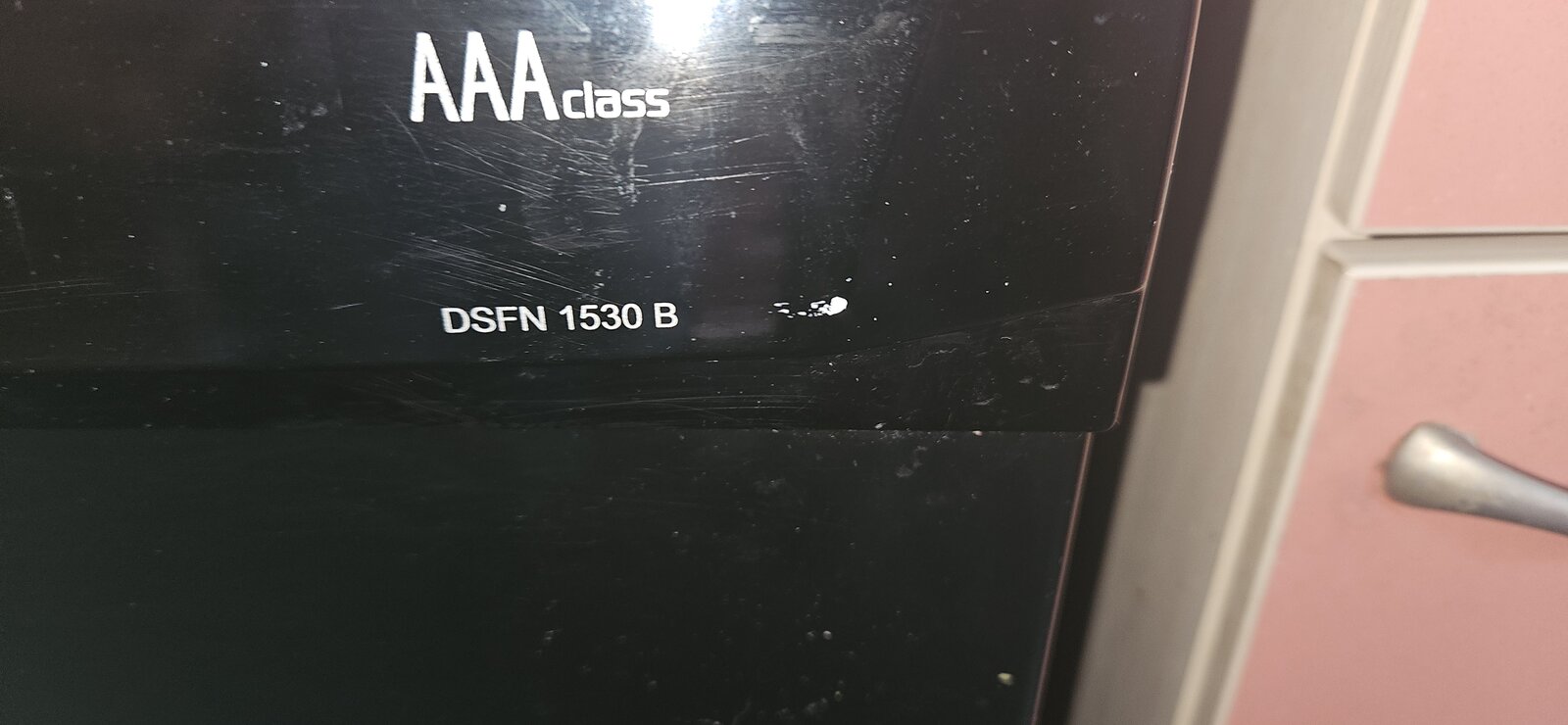

Is this the side seal or the bottom seal
Or something else
It's a beko DFSN 1530B

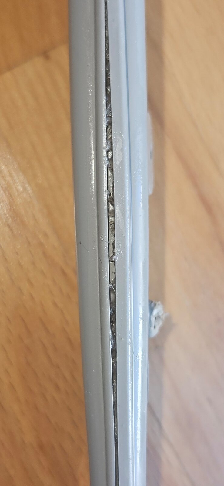

Have a close look at the lower spray arm as they split on the side seam and push water out just like that.
Don't think that model number is quite right.
Looks like your right.

A new lower arm will sort that, part number 1764790100.
You got the F&S on the model number round the wrong way on the original post.
