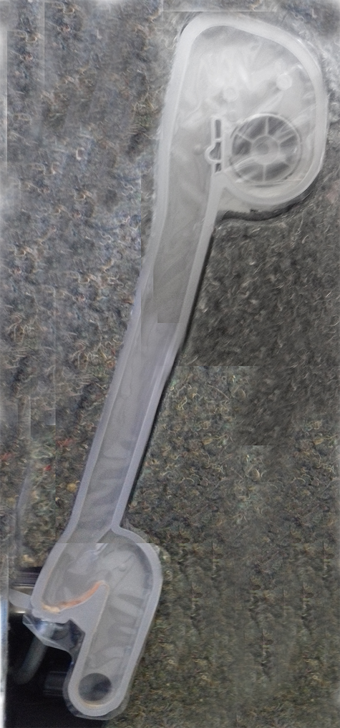

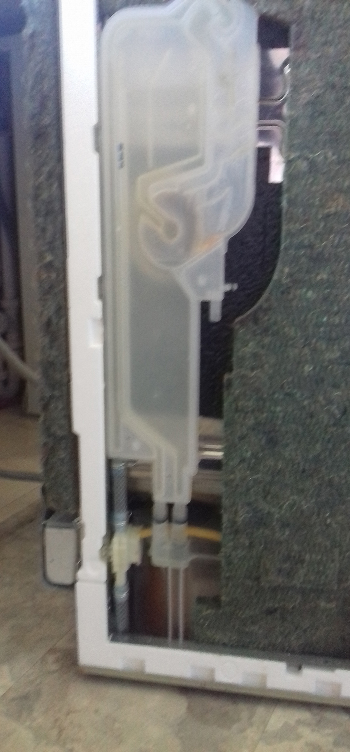

Out of curiosity I remove the side panel again to show you what it looks like.
It is something to do with the Hot dryer. Note on the bottom of the right-hand view there is a large hole which you can see through the clear covering.
Any water in here will drip into the catch tray. I don't understand why there is so much pressure to pop that plastic pipe off as it is just an open exit.
The Right hand view
You can also see a small residue of the FAT that caused the pipe to block..
Anyone know how this system works?

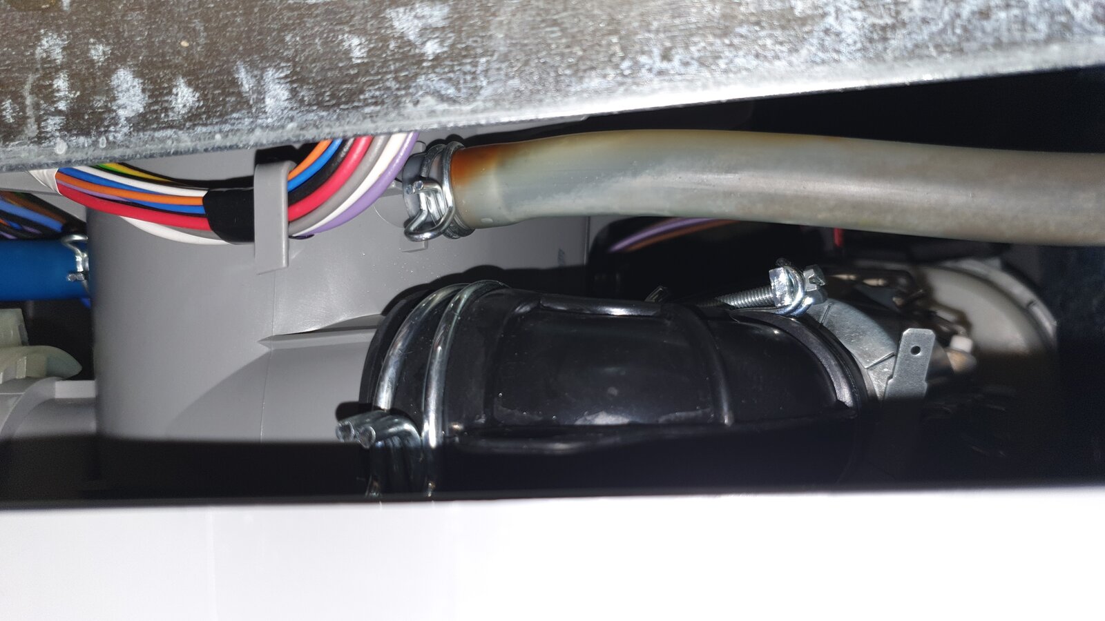

For me, tipping the machine forward was only temporary solution, each time it would leak water and stop the cycle.
I removed the lower front inspection panel and saw a hose was fallen off the filter.
I refitted the smaller clear hose and dried the machine, now it works OK.
