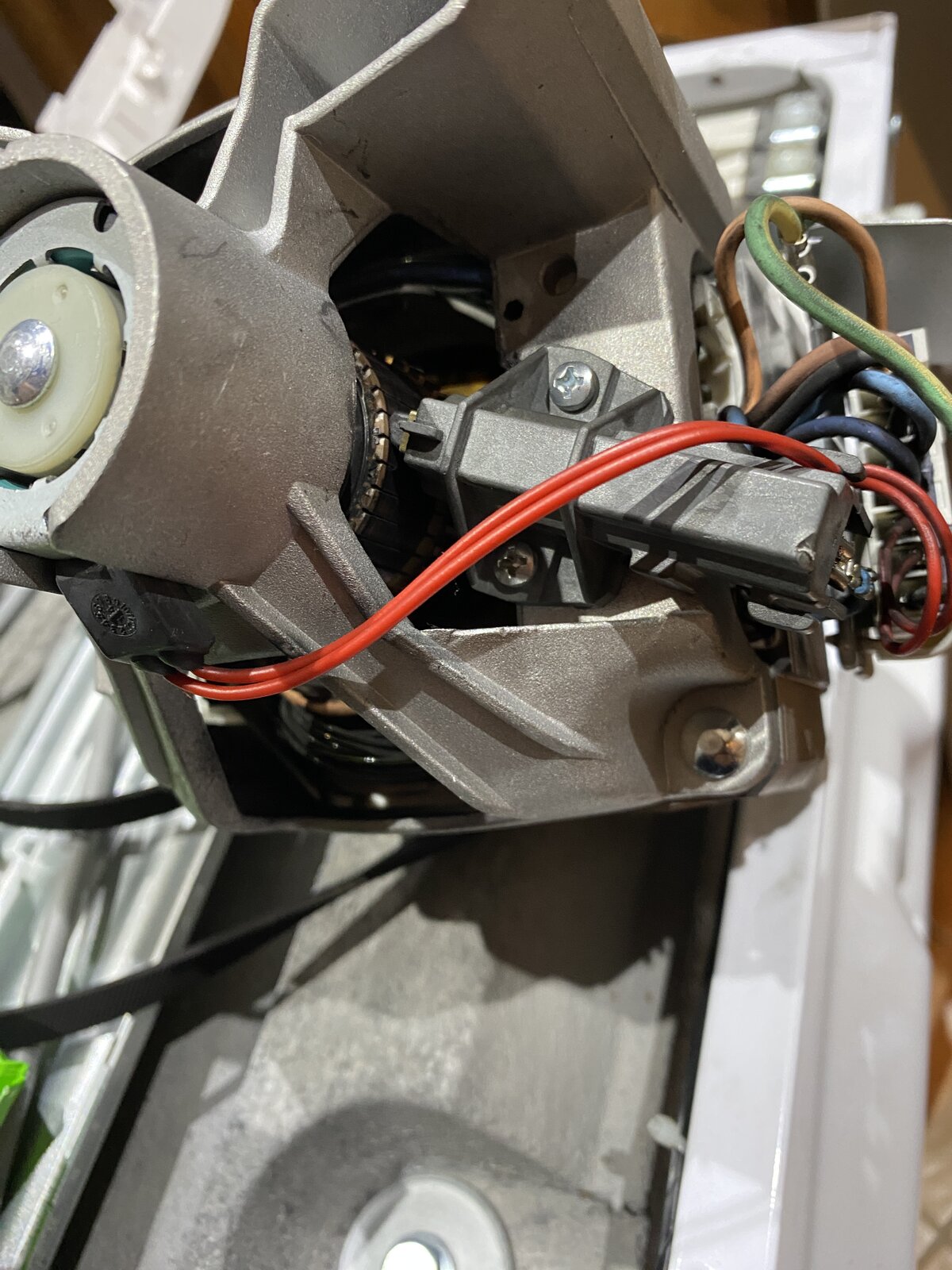

My daughter has a Beko washing machine 'WMC126W' of approx 4yrs
Today it tripped the circuit breaker, but since looking into the problem, the circuit breaker has not tripped since.
But the pump, door lock and front control panel functions are ok. The motor does not drive the drum to rotate. The drum attempts to move slightly in either direction and stops. Removed the belt, drum and motor are free. The motor when called for will move about 5mins each way as on a clock face, then spin up to speed and stop with no load/or belt fitted. Removed the brushes and both appear of a good length of 25mm plus and the com shows no signs of burning or arcing.
Opinions: Would it be the Control panel board, Motor or something else ?

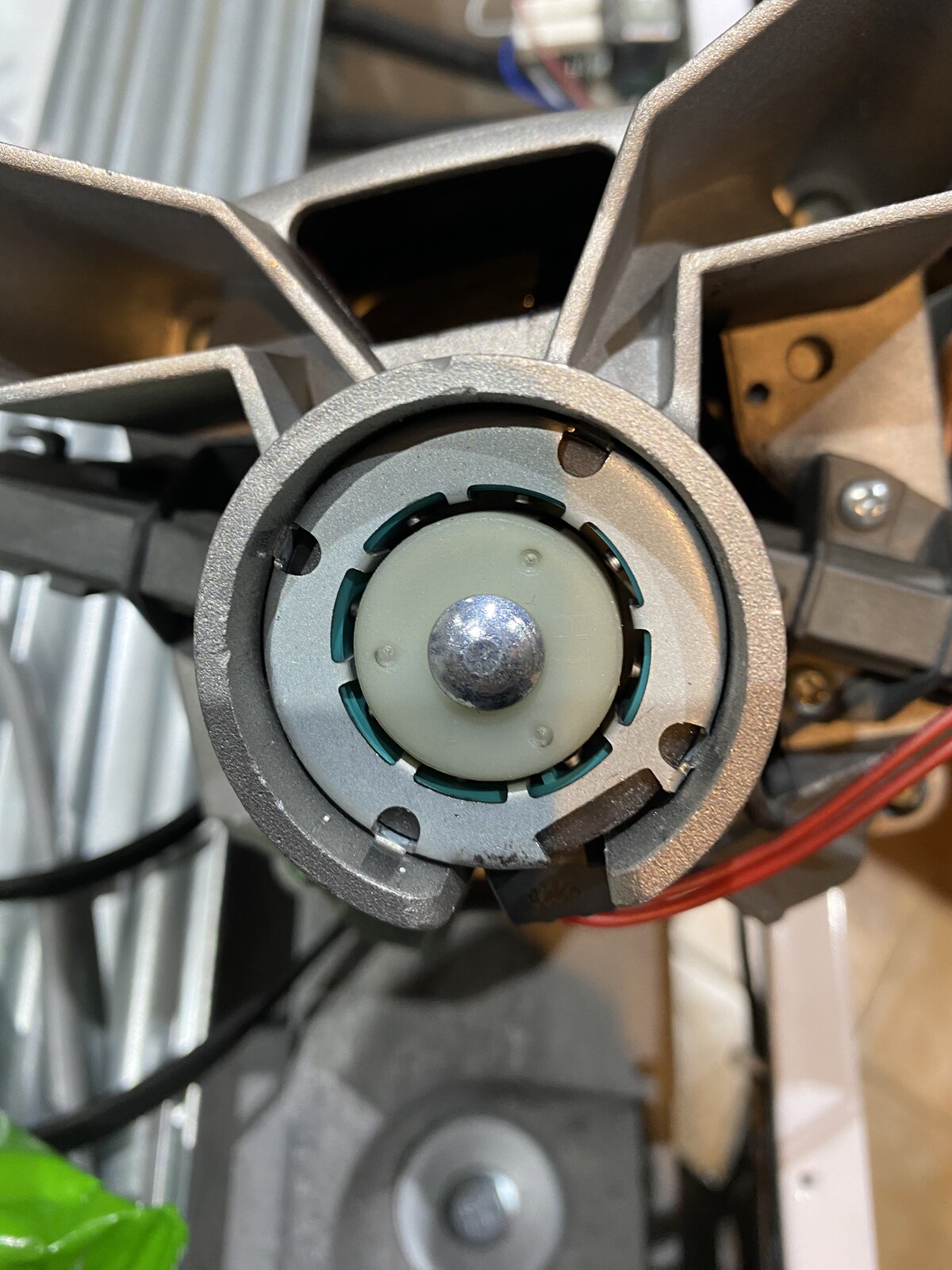

Tested motor armature and field windings, both between 1.0/3.0 Ohms.
But sensor is 114 Ohms which is high ?, think it should be approx 2.0 Ohms.
Are these sensors replaceable ?
Not seen and listed as spares.
Rear of motor to armature shaft
That doesn't really help - I'm trying to determine what sort of sensor it might be. Presumably it will be a speed/rotation sensor of some type, and its failure would explain your symptoms. Can you post a photo of the sensor?

Below is the sensor that appears to be high in Ohms in its testing
My best guess on that sensor, is that the rotating part is fitted with magnets, then the stator is just a winding. As the magnets rotate, they induce a current flow into the windings, the current (red wires) is then fed to the PCB, which confirms the motor is rotating and the speed. I would suggest the 44 Ohms across the two red wires, is not far out from what I would expect.
You could test the theory, by connecting your meter, set on volts, across the two reds, then spinning the motor by hand - see if a voltage is produced, if so, all is well with the sensor, and you need to look elsewhere for the issue.
Of course, I might be very wrong.
But as said the sensor shows 114 Ohms where read it should be lower ?
Sorry, I was distracted here - Yes, I meant 114 Ohms.. Yo.u will need the meter on the ac voltage range.
Another test you could try, is actually running the motor under power, with the red wires disconnected - see if it's behaviour is any different to before..
Will check later visiting daughters.
But have been told its a Tacho’ not a sensor
Correct - it provides feedback of the speed of rotation, to the pcb.
There are various ways of doing it, hall effect sensors, back emf from the motor, magnets and coils etc.. Your system looks like the latter.
