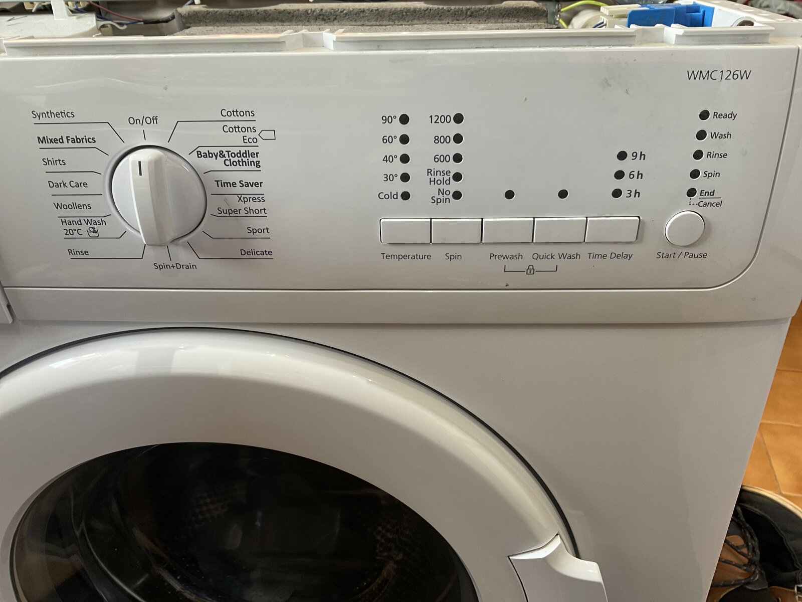

Beko washing machine motor problem
If the testing results show major fault on the motor, could the PCB board be the issue ?

Machine has no display, just buttons and leds.

Refitted the motor and tried to enter the diagnostic mode. Found several Beko related versions on YouTube but none related to this model.
One I did find, with machine turned off, main dial in on/off position, while holding Start/Pause button and turn machine on to first position which I assume is 90deg, release and press again, all lights flashing.
Turn dial to position 6 assuming thats Sports with lights still flashing, then press Start/Pause stepping through squences. When first started this procedure the motor started through the various tests with rinse, water in and pump water out as expected.
Tried again, motor back to its original fault as described in earlier posts.
Tried to do the 5 led test which tell which component is at fault on YuoTube. But this applies to another model.
Think its time to get an engineer to sort it and decide if its worth a new motor or new machine Unless you know of another test squence.

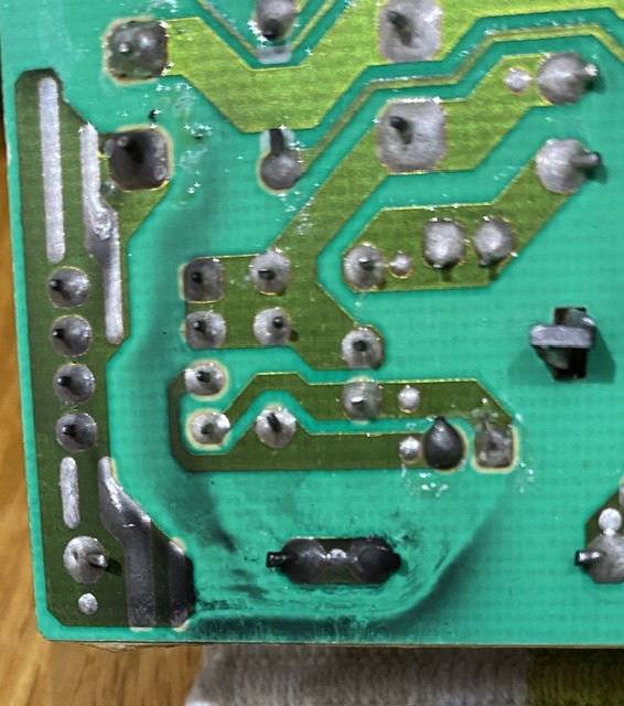

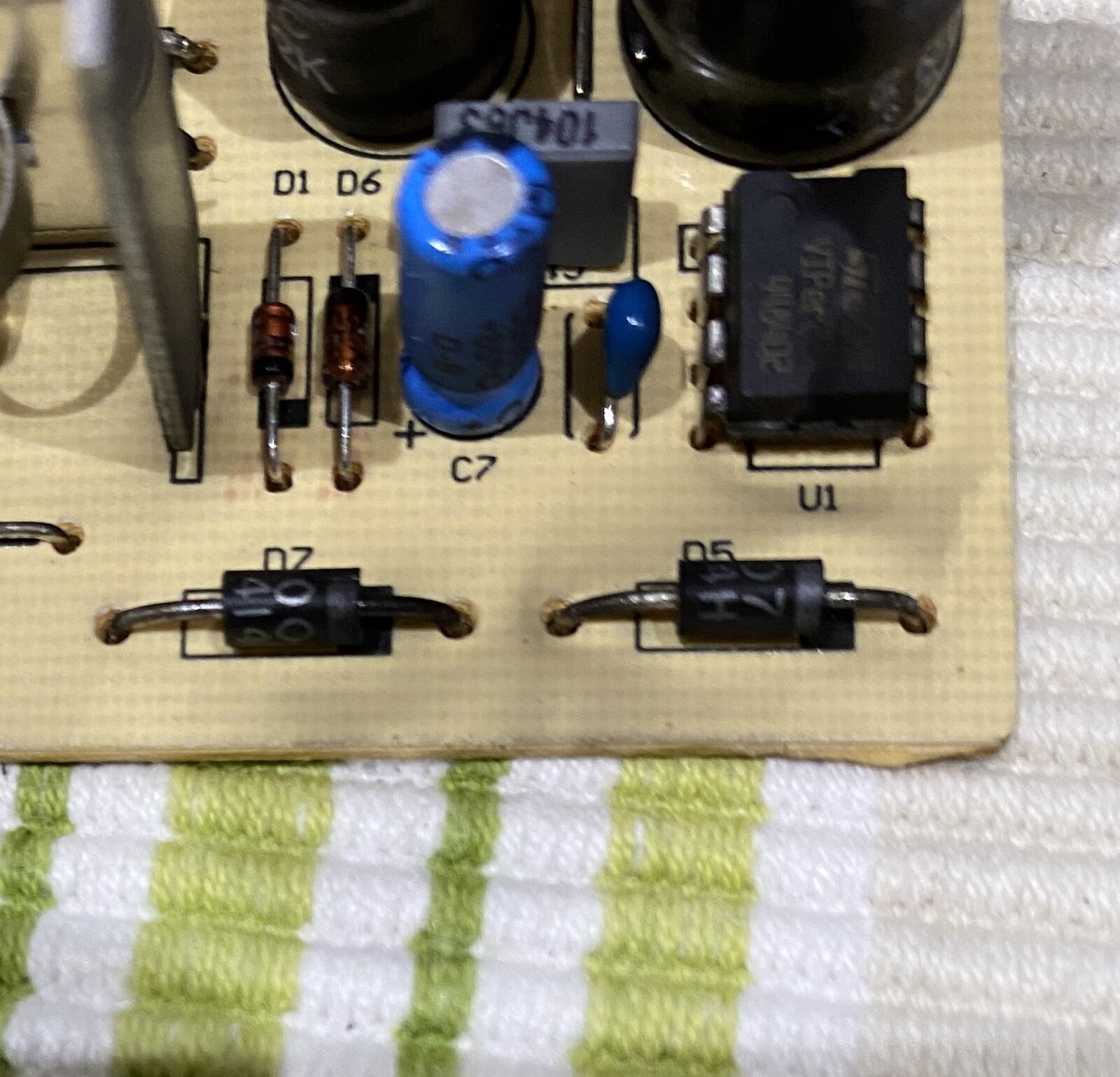

So decided to remove the control pcb board.
Found what could be the cause of the problem, burnt areas and solder joint on the underside around a capacitor (not the blue one in photo but black one out view to right) and 2 diodes.
