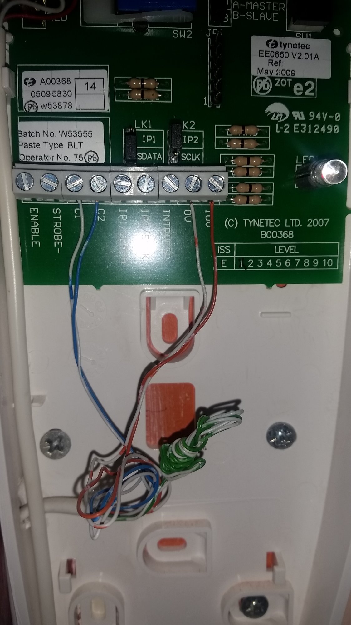

Hi I am trying to replace a entel 300 door entry telephone with a bell 801 entry telephone I bought from amazon the wiring for the entel 300 is below
10v orange + white
0v white + orange
C1 white +blue
C2 blue + white
On the bell 801 it has markings I R O T Z I have no idea which wire goes were I have tried a few combinations but no luck :(
Any help greatly appreciated

Yeah I have only bought a new handset the picture is hiw my old handset was wired can't figure out how to connect the new bell 801 handset :(

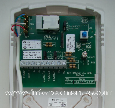

Ok iv looked and I'm going to order a TYNETEC ZFT 210 it says it's a replacement for entel 300 and has same connections so will hopefully work, and send the bell 801 back to amazon for a refund. I am replacing it becouse the switch is broken so when u lift and put down the phone it doesn't do anything can't accept calls think it was tampered with by previous tenants
Are you sure the switch is broken ? The Tyne tec handsets do suffer if the front is not clipped on fully !
I'm sure it's broken asit's just floppy and doesn't move by itself
