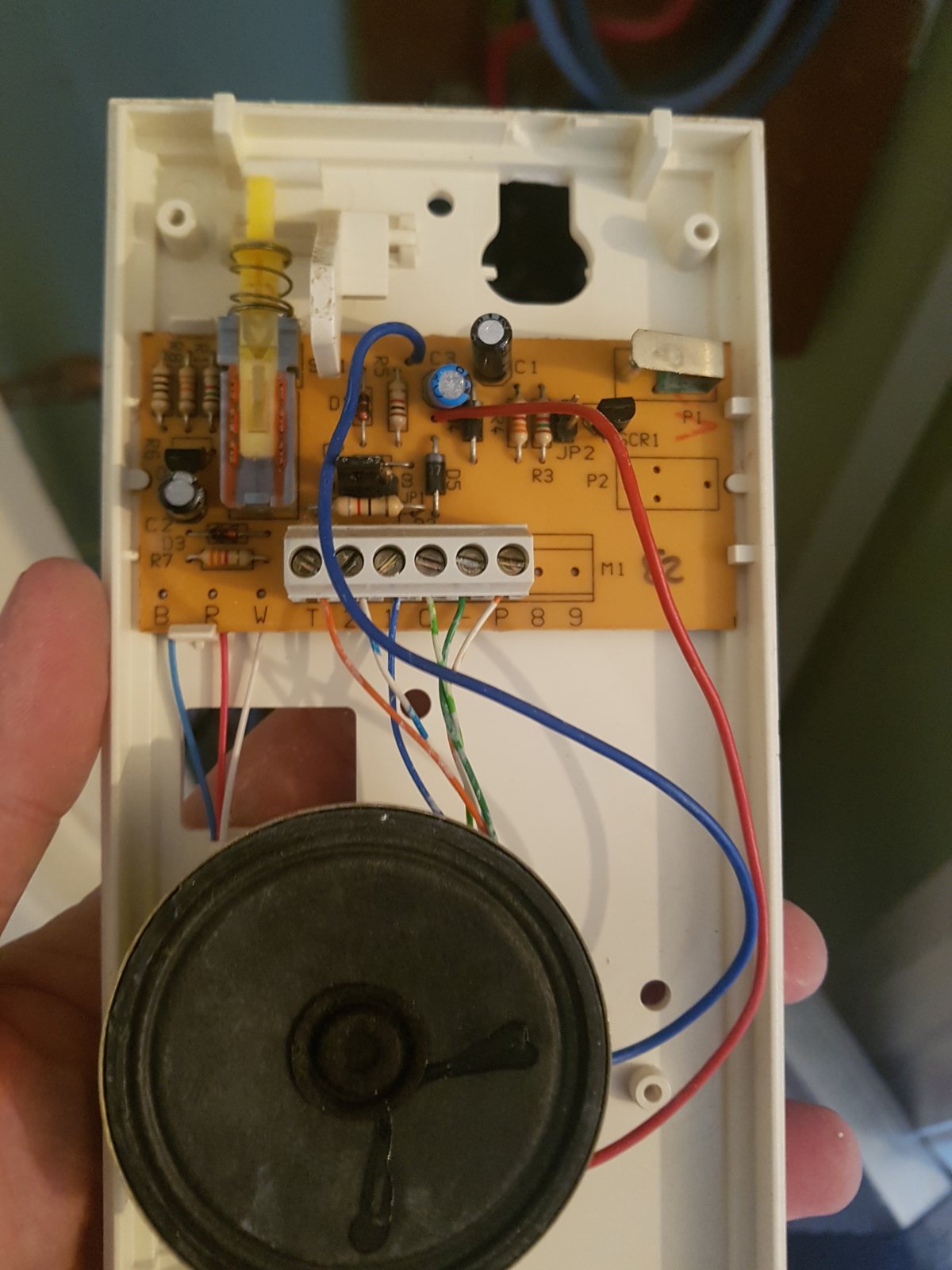

They didn't look well enough aligned to me, but you could be right. In which case, it's something like:
green = 11 = call = I
white =1 = speaker = T
blue = 2 = mic = R
grey = 9 = lock = Z
red = 6 = common = O

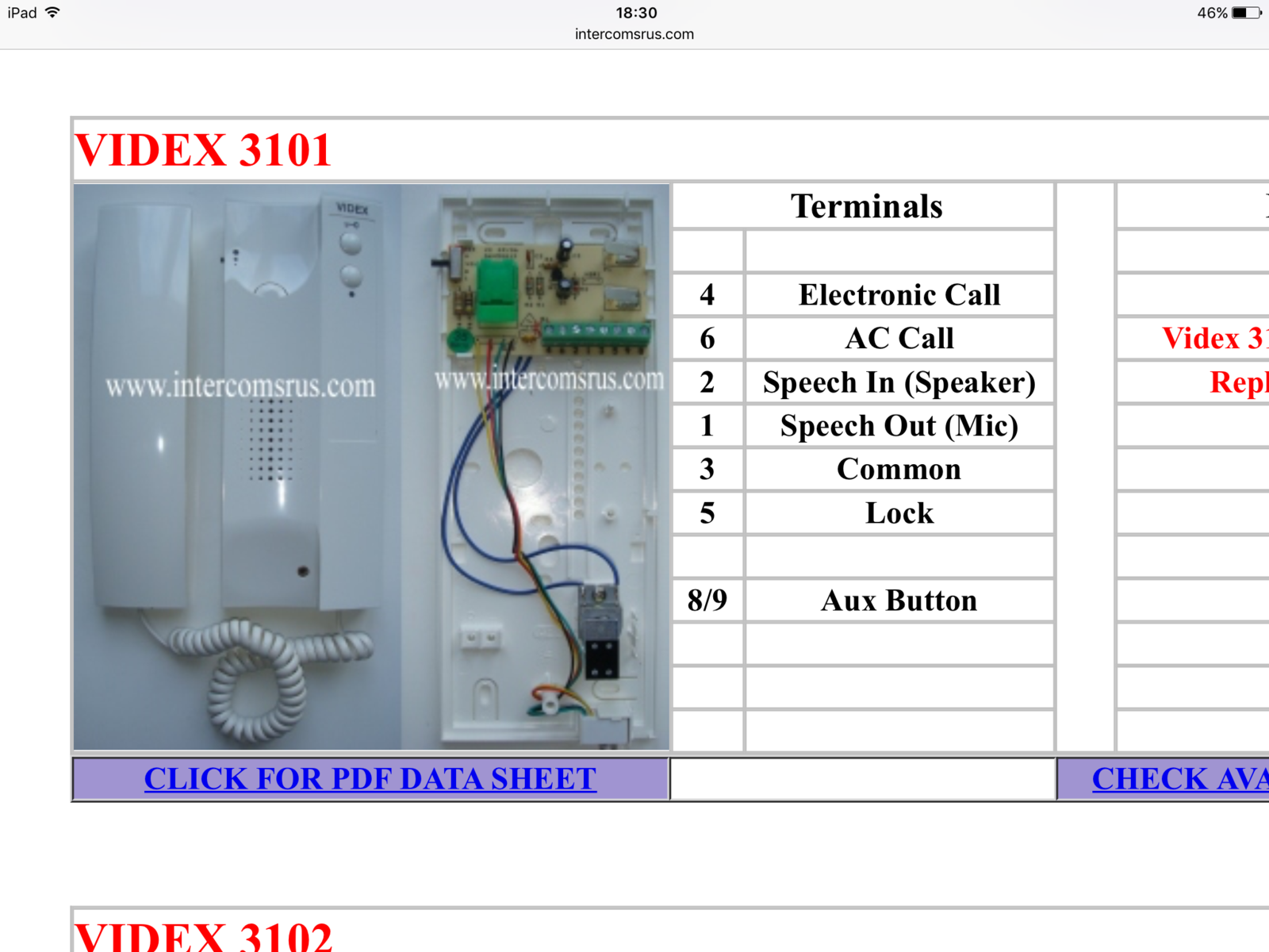

I have a videx 924 entry phone and I wanted to replace with a videx 3101 which I understand is the correct replacement.
Having looked it's just a case of a straight swap with the cables into the same terminals as before but it doesn't seem to work.
The terminals on the old system are labelled with letters and the new system is numbers.
Can anyone shed any light?

Photo attached of the old system

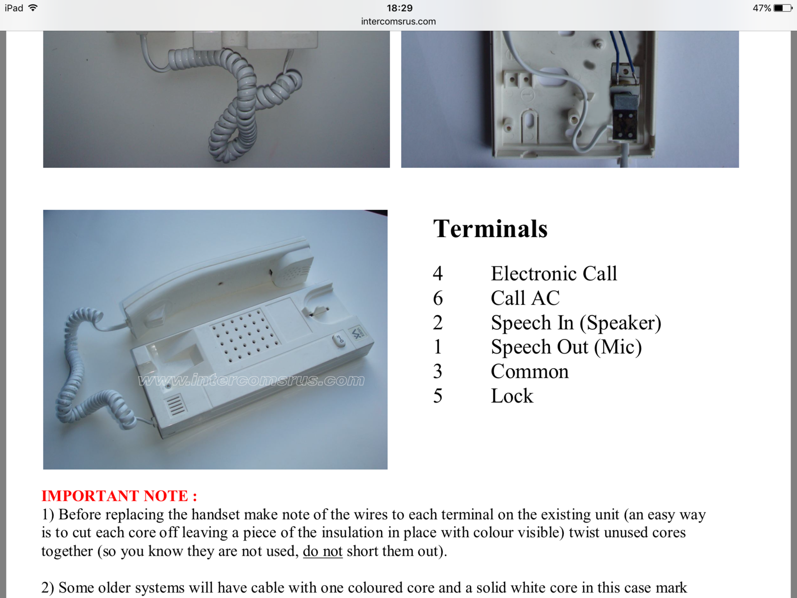

I haven't yet no, I was basing it on a sheet which was put together on this thread but on the manual the ports are assigned to the same things such as call out, etc and I've wired it exactly the same leaving just the 2x extra ports in the new system which were number 8 and 9 but these weren't on the original 924 and the 2x brown cables weren't used
