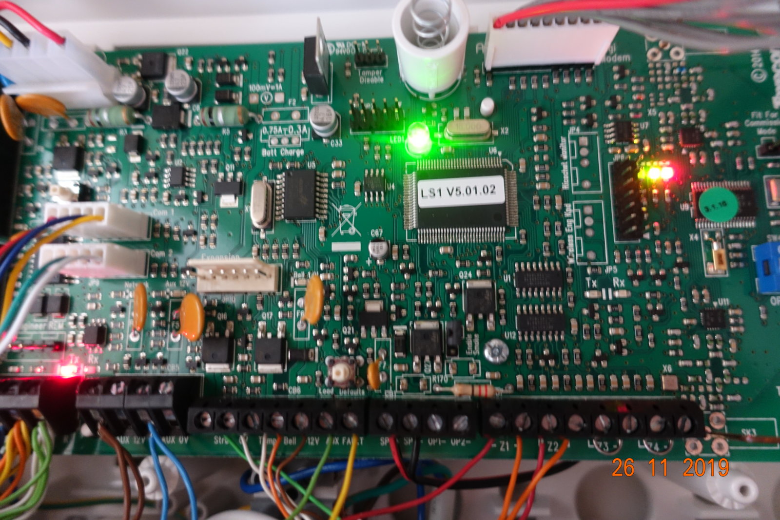

Help please, l disconnected my Texecom 64w panel from mains, and, battery, for about 24hrs the other day, because my alarm went off for no apparent reason, and the master, or engineers code would not silence the bell. l have disconnected the alarm cable from the panel, and returned all power back to the panel, but when l try placing the alarm cable on the panel alarm terminal, the bell goes off again. The only red lights showing in ONLINE STATUS AND CONTROL is for PANEL BELL OUTPUT, SYSTEM OPEN, COM 2 POWER, and PANEL BOX TAMPER OPEN.lt seems like a reset problem, but the keypads are only showing the panel tamper.
Where is it wired in the panel ....post pictures.. does it only ring when the bell trip wire is connected ?
yes, only when the bell cable is connected, the bell cable is ORANGE ( THIS PHOTO WAS TAKEN BEFORE THE PROBLEM)

No they are correct as you can see from photo just taken, the bell cable is missing .
l do not have a photo of the actual bell connections.

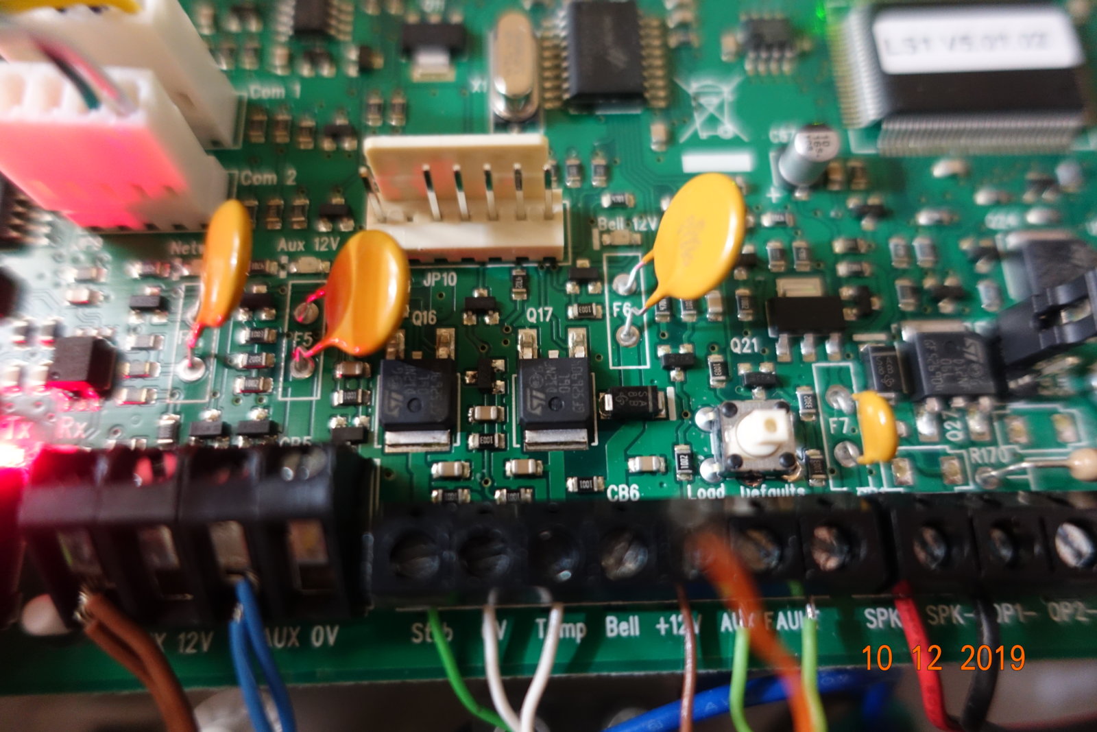

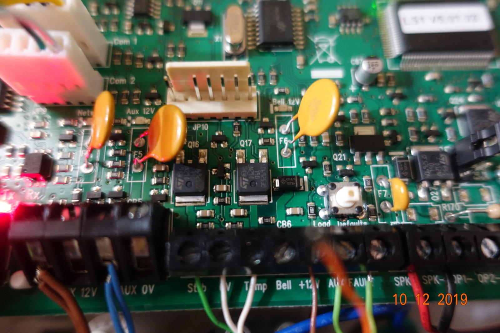

What happens if you put the orange wire in with the strobe green wire ? Does it ring ?
better picture 2nd time, was looking on phone earlier
2 white cables?
0V and Tamp?
is that a loop for the bell tamper at the panel, if so wheres the power to the bell wired across and which bell.
which bell is this connected to and is the bell set to SAB or SCB?
same with programming in panel?
also as suggested how does the bell/strobe respond when orange into strobe?
