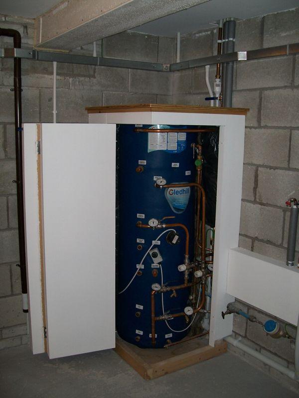

I like the way the plumber installed his bits so neatly, and dressed all his cables properly....
Sometimes it is just easier in a plantroom to space the trunking off the wall with unistrut thus allowing pipes and other services to run beneath it so no need to keep making sets over them.
Nice.
I hadn't finished the wiring when I took that one, though there is little to actually fasten the cables to - apart from hot pipes. The plumbing is mine as well, rather irritatingly I didn't get some of the pipes straight.
I did think about that. But these are the only sets needed, the rest can be straight on the wall. I did consider whether to take the brown drain pipe over the top of the trunking instead ...
